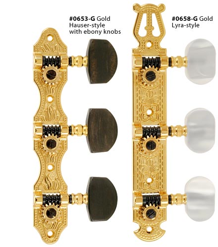

By the way, does anyone have a favorite classical tuning machine for less than $100?

As for good, economical tuners, I prefer those made by Schaller, specifically the "Hauser" ones. They are smooth and accurate. At a bit less than $50 for a set, I consider them to be an outstanding value.

Gotoh that you can get from LMI or Schaller that you can get from Stewart MacDonald are both good and will be under $60.00.

I like these at $64 with Hauser style with ebony knobs 0653-G
