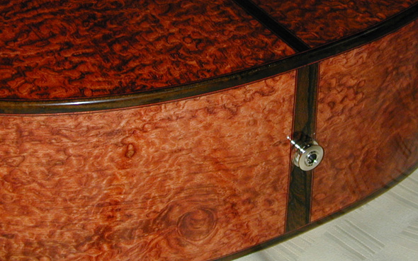

Clinton, here is a quilted bubinga done with Ziricote bindings, purf is blk/orange/blk ... dark browns, with black lines, sometimes shows somewhat of a really deep olive colour in there too ... see the spiderweb graining on the tailwedge ... also when dead on quarter, has really nice fleck spots to it ..
TonyKarol39087.4137037037
PostPosted: Fri Jan 05, 2007 2:00 am
Hey Tony, the wood on that Git is all deformed!
PostPosted: Fri Jan 05, 2007 2:26 am

PostPosted: Fri Jan 05, 2007 3:21 am
Yeah, that tree was on DRUGS man .... some whacked out natural herbs or somethin' ...
