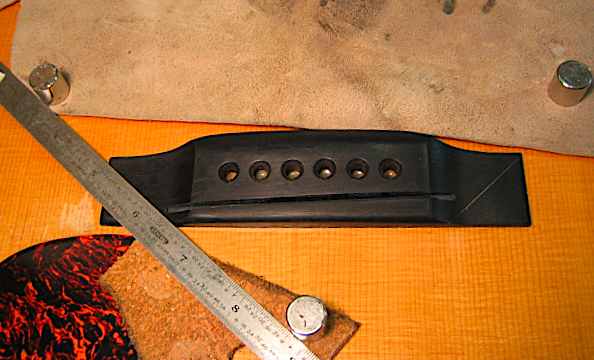

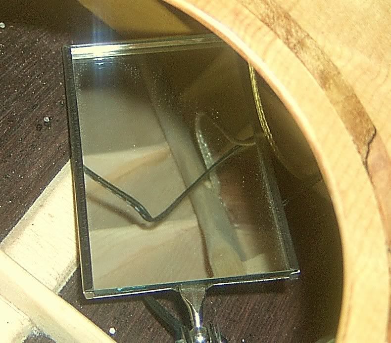

PostPosted: Sat Jan 06, 2007 1:23 pm
Posts: 1969
Someone asked for pictures.

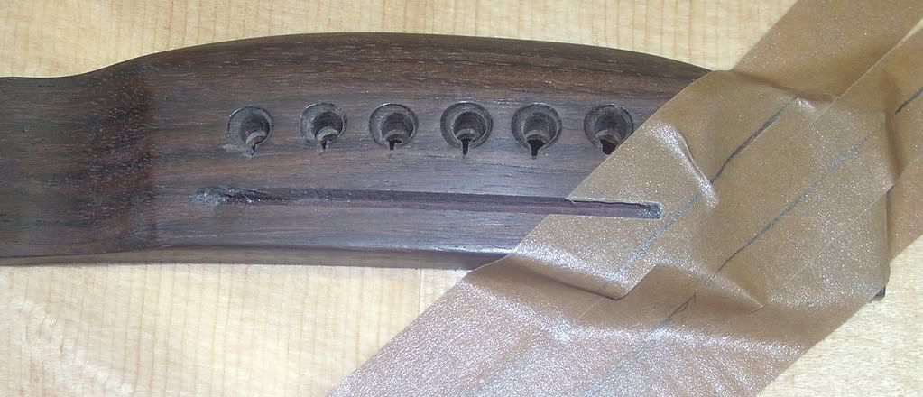

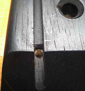

PostPosted: Sat Jan 06, 2007 6:11 pm
Posts: 1969
[QUOTE=Billy T]Just rough cut the spruce to close the diameter and tap it through, it works pretty slick![/QUOTE]
OK - How's this?
I'll wait for the glue to dry and sand it flush in the morning. With the dowel in there, the hole doesn't look so big. I think a lamination will do the trick.
I told my friend about it already and will show him the pictures. I explained that if there ever is a problem, I'll fix it. I really don't think it will be any issue.
I'll post more pictures as I work through the repair.
Any comments and suggestions are welcome, well, almost any.

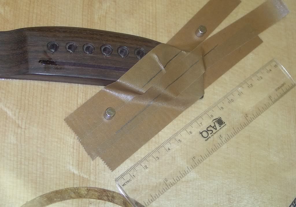

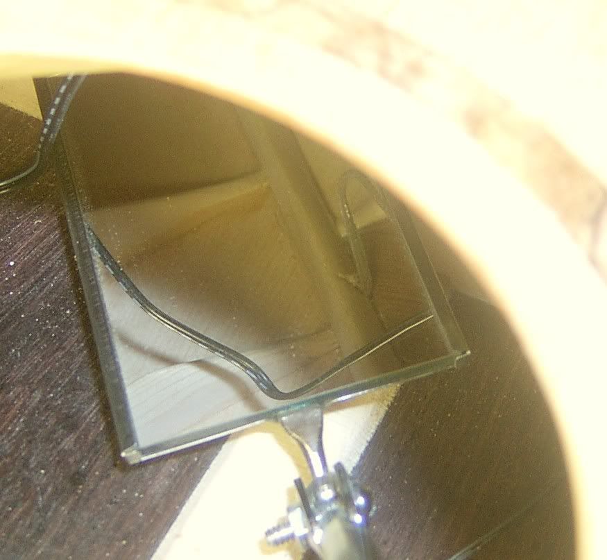

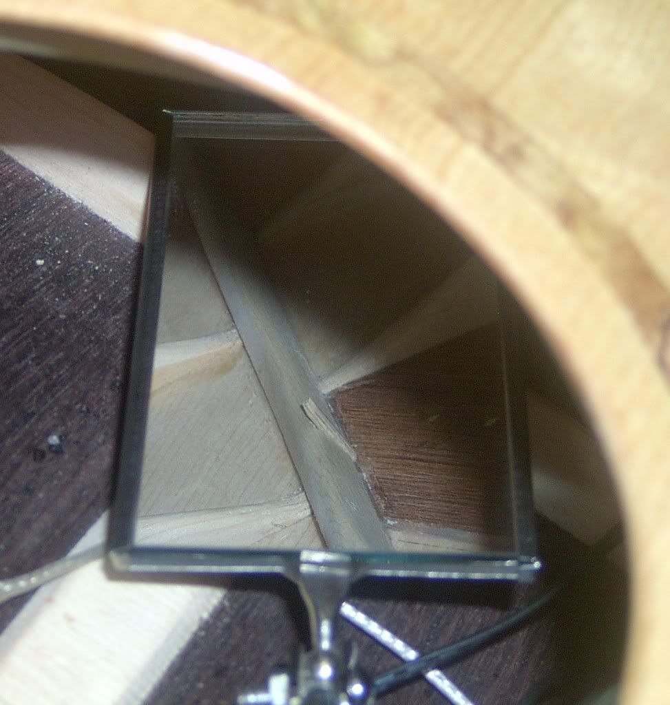

PostPosted: Sat Jan 06, 2007 6:18 pm
Posts: 1969
[QUOTE=David Collins] Not to rub it in, but a few magnets and a straight edge can save a lot of
headache.[/QUOTE] Dave,
Thank you for the great tip! I had some magnets about 3 feet away - Dooh!
Here is my first time with the magnets. Please see the traces below.
Does anyone think it is a good idea to try to place a UST in this guitar?
It looks like the angle I'll have to drill will be very
shallow, making it a very long hole.
I don't think the hole should be drilled almost straight down either, or is that OK?
PostPosted: Sun Jan 07, 2007 4:19 am
Posts: 2060
I would drill close to straight down (and maybe tape a feeler gauge to the
brace just in case). Even though the element transducer does not like a 90
degree turn I've had good results by softening the curve with a small chisel.
Whether it be by file or chisel, whatever you can do to soften that 90 degree
corner to a softer curve will be helpful. Leave it too sharp and your low E will
overpower everything. Cut it too long and the low E will be quiet if the slot
drops off too close to the string. Still, I wouldn't shoot for the outside of the
brace. That's just drilling too far through too much wood, at too much risk
of problems both now and later (I'd hate to be the guy who had to reglue a
bridge glued like that).
