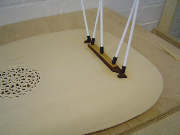

It is possible to get a decent FP finish with the bridge on, but difficult! I have to do it on my lutes as the bridge is glued on before the top is glued to the shell (no soundhole to put a clamp through). I make a small rubber using a piece of hard felt for the padding that is cut to a wedge, this allows the rubber to work right up to the bridge.
However, on a classical, leave the bridge off till after you've finished. Still make the felt rubber though as you'll find it useful for working near the fingerboard.

colin, wouldn't a vacuum clamp resolve the problem of the inability to clamp through the lute's ornamental rose?
PostPosted: Tue Jan 09, 2007 12:03 am
[QUOTE=crazymanmichael] colin, wouldn't a vacuum clamp resolve the problem of the inability to clamp through the lute's ornamental rose?[/QUOTE]
Yes it would Michael, but I try and build my lutes in as traditional way as possible, I use no power tools at all when I make them, and I try not even to use sandpaper, just shagreen and scrapers (OK I use sandpaper rolls on the rose). Bridge placement is done by very careful measurement.
