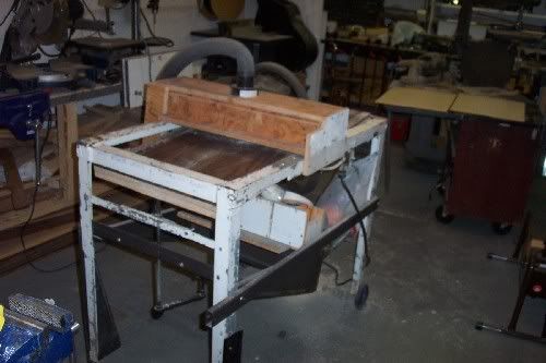

Q1 : Thickness sander or home made drum sander or Wagner safe T planer on a drillpress or if you love planes go for it!
Q2 : I'D SAY 0.140-0.150" THICK
Q3: mine are ~ 4-5" apart

Serge buddy, thanks for your answers! However, I’m a little stumped on part of your answer to Q1.
Oh, I suppose I could do the research. But, it would be a whole lot more fun to hear you tell me
how to hook up a planer to a drill press!

Robert, my answer was, i admit, rather confusing but hey, i got French in me Canuck!
I meant that you have a variety of options, the most prefered or ideal would be the one that some call the thickness sander and others call drum sander working with abrasion. Works with a drum and sandpaper and you thin your wood a hair thick at a time. I built my own with the pile of junk that was laying around (read "lack of money" between the lines ). Will post a pic of my monster machine today.
the second option would be the tool called Safe-T-planer that chucks to a drill press but you'd need a very wide drill press i believe and Colin and Mike Spencer use these.
Finally, some use planes to thin their woods, if you're used to work with these, you're good to go!

PostPosted: Fri Feb 02, 2007 1:35 am
Here ya go Robert buddy:
My Monster thing!
For the Safe-T-Planer, maybe Colin or Mike will show a pic of their set up? I think Stew Mac sell the tool, if not, LMI does.

Wow!!! Serge,
Did you have to tame that thing down a bit after pulling it from the black lagoon!
Seriously though, it does look to be a powerful machine.

PostPosted: Sat Feb 03, 2007 4:52 am
Robert, it ain't pretty but it sure helps thinning headplate veneers or the woods for the soundbox, heck, everything for the guitar for that matter!
It's got a 1/2 HP MOTOR AND 1/4 turn on the threaded rod and you thin a hair at a time!
