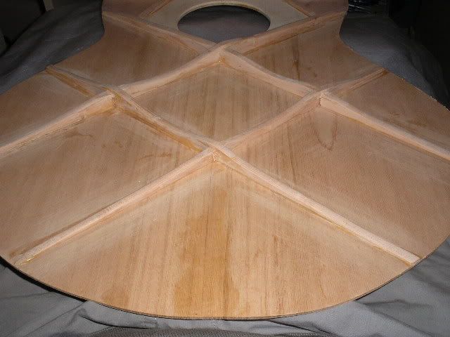

sorta like this you mean?
This was done at a class taught by Sam Irwin. One of George Lowden's original 4 employees WAAAAY back in the olden days!!
The guitar turned out great and is sitting accross my lap as I type this!!
