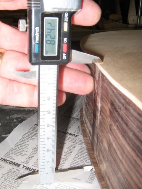

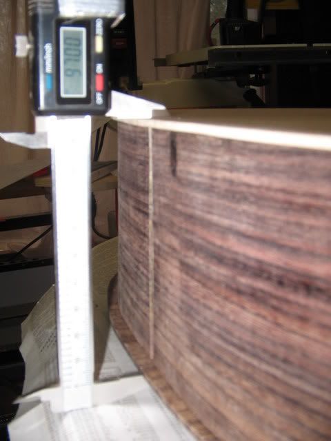

Here are a couple of photos..
as you see my top and back glued on depths will be ( they are just clamped in the photos..)
end block...
  and
heel block ..
so pretty well a thin ( thinner) than planned OM...any other considerations for the rest of the build.do you think neck dimensions or anything else have to be modified...(obviously the heel of the neck will be shorter) because of the shallow(thin) body ...Thanks

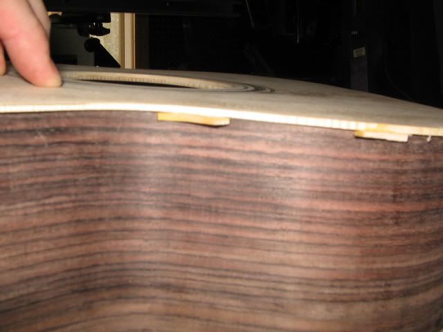

Tracy, I would replace the kerfing but I have already recessed(?) my bracing into the sides..(cut the little area out of the sides)
if I was to replace the kerfing to get the added height I need, wouldn't the binding on the guitar need to be quite thick to cover the now open area in the sides (that I cut to inbed the braces)which would now be a fair distance from the top?
Sorry I may be way over/under thinking this..

You are right, you will not be able to raise the kerfing very high or else you will have big holes in the side of your guitar. However, what if you raise the kerfing 2mm on both top and bottom. That will add a total of 4mm to the thickness of the body, and I think that will also cover those brace end holes with the binding. If you feel that 4mm is not worth it, then carry on and chalk it up to learning. There will always be mistakes, it is just how well you choose to cover it up. So don't worry about it. Good luck!
