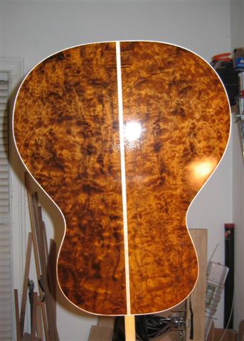

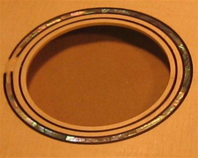

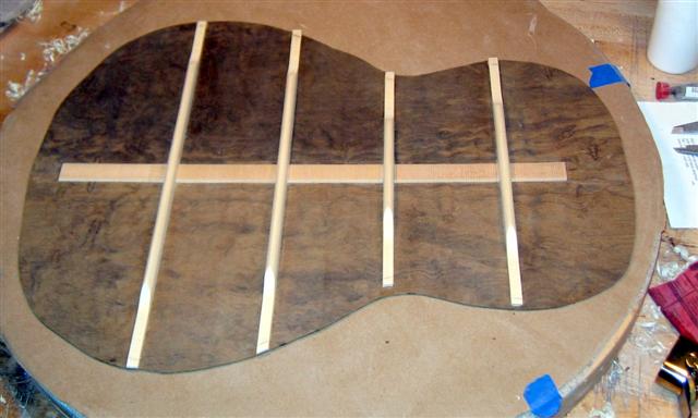

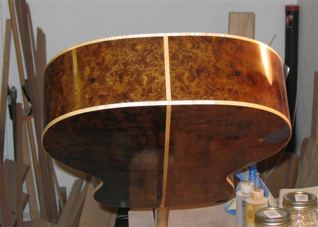

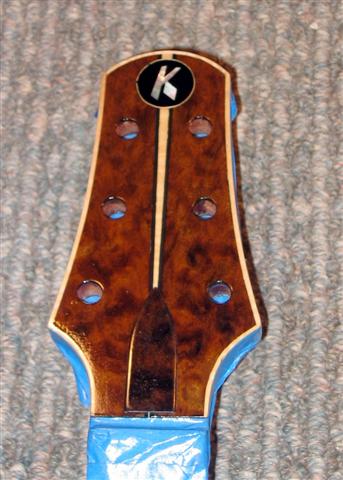

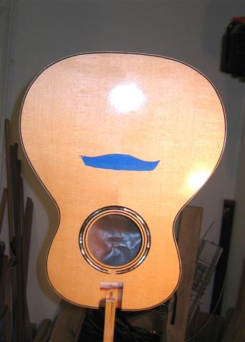

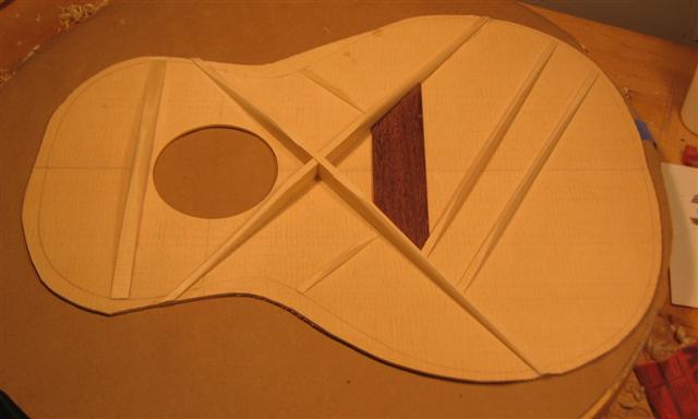

They seem to be as common as OM's these days, but here's one I'm working on. Needs two more finish coats of lacquer, but it's getting close...
Sitka Top
Imbuia B&S from Bob C via R Labbe in last year's swap meet
Gotoh tuners from Peter's group buy
Remaining bits and pieces from the usual suspects.
First time working with Imbuia, and it bent and machined much better than I expected given its figure. (The maple bindings were more of a hassle.) Second time working with a double m&t neck and I'm extremely happy with the results. The fretboard stays nice and straight and I love being able to string up the guitar and make any neck adjustments and do the fretjob before there's a drop of finish on the body. Plus as soon as it's buffed out you just re-glue the bridge and bolt on the neck and you're done. Almost instant gratification.
Thanks for looking.
Bob K
Sorry for all the pics, I guess I've been saving them up.

Bob, thats one fine looking guitar. I really like the stripe in your headstock.

Also, I am curious how thick your top was
Andy

[QUOTE=Hesh1956] they are getting much more popular at least here on the OLF.[/QUOTE]
It's all Swanson's fault!!!
Your "L" is shaping up nicely, Bob! Smooth work on those top braces.

[QUOTE=BobK] Second time working with a double m&t neck and I'm extremely happy with the results.
OK, you've definitely caught my interest!
Does the “Double M&T Neck” involve some kind of jig?

Thanks for the kind words, guys.
Andy, I did the deflection test explained on the "LINT" forum and started with a thickness of .120. I'd be curious to hear what you started with as well. http://www.lint.org/index2.html
Robert, It's pretty simple. Most importantly, you need to add an extra block (i used mahog on the first and ply on this one - ply is more stable) to your heel block. Cut the usual m&t first to fit the rough neck blank. Then I made a simple router template that keys off the truss rod slot to cut the top mortise (neck and body at the same time). Be sure that your mortise is more narrow than your fretboard - and that it stops well before the upper face brace. Cut a tenon to fit the mortise. Remove the neck from the body, glue and level the tenon. Lengthen the truss rod and or cf slots as necessary. Reinstall the neck and drill hole(s) for inserts and screws. At this point you continue as if it were a regular neck. I'll be happy to show you the details at the gathering. Also, do a search for John Mayes' version of this joint. He uses a tenon only glued to the fretboard, but he probably explains the process better than I did.
BobK
