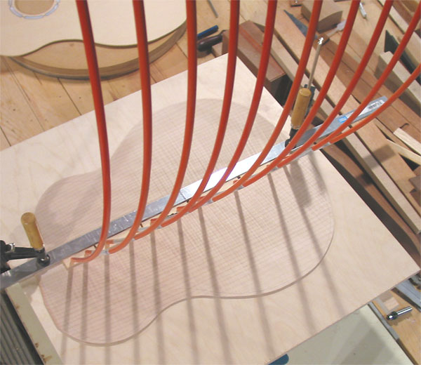

the way I do it...
Stewmac straight edge to keep it lined up. Go bar to protect the backgraft,
and go bars clamping it all down... Not so great detail picture.

I guess one good pic deserves another...

I do it a little different. I glue the braces in first, then shape them, I find it easier to use a plane to shape them if the center strip is not there. Once the braces are all shaped and sanded I piece in the center strip.

[QUOTE=LanceK] Great pics guys!
+1, although it appears that Hesh has his "system" down to a significant, well-polished science. And I second the motion that, at some point, we need to find a place for these pictorials (all of them, not just Hesh's) so that they can be easily referenced.
