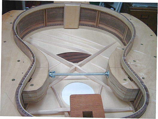

            With my current 12 string project I have elected a 24.9 scale . A bit less tension and a slight ease in playing considering the wider neck.
A 13 fretter, Which I'm hoping will be a little less leverage on the neck , but more importantly ,place the bridge back to a better part of the soundboard .
I've also used an Englemann top . I'm hoping to lesson the 'jangle' with an Englemann tone.
My bracing is very light , but still incorperated the third lower tone bar , although it is really small ( 6m.m. in hieght ).
Also I have included a Lowden type A-Frame to help cope with the extra string tension . Hope this helps.

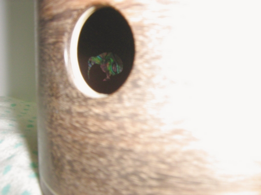

I also have a soundport !! The little Paua Kiwi is inlaid into the headblock.

Very Cool Craig
PostPosted: Tue Apr 17, 2007 1:59 pm
Bob,
I wouldn't necessarily choose the top on generalities.
I'd pick the stiffest top you've got. In other words, I think any of those species would work, if they were stiff enough.
You are quite correct about the upper end jangle. I built a 12 string using a Koa top. It sounded like Roger McGuinn with the treble all the way on 10. Amazing...the sister 6 string with a sister Koa top sounded dark, rich and anything but trebly.
I used the 3rd tone bar, as well as a 3rd finger brace.
Oh yes, also a larger bridge plate. Don't scallop the "X".
Good luck,
