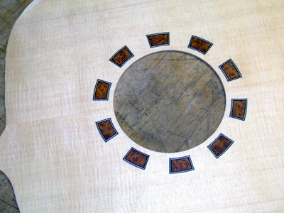

Theres been a rash of rosette posting lately (okay 2 or 3) and I just finished this one last night which is a new design for me. Thought I'd post it as it's somewhat different.
and a close up

That's fantaaaaaastic. Inlaying bevels into spruce - you're brave. Sure pulled it off well, though!

You just sent a rush of ideas through my head, that is a great looking rosette

Cudos on having enough cohones and skill to pull it off!
Camphor burl?

Thanks, It was definately an exercise in miters for sure. 80 of em!
The wood is Thuya burl, which I believe is in the cedar family.

Jim, you old trickster! That's mighty impressive--both in workmanship and design. The Spruce for the top looks incredible, too. Tell us more!!! Also, what sort of beast will all this turn into?

I you have any pics, how about a mini-tutorial on how you did this? Thanks for showing us the results, the rosette is a knockout.

I'm interested in the details- it looks like mostly hand work (vs router jig, CNC, etc)?
Please enlighten us!

The technique was a combination machine and hand work.
I'm working on trying to get a poorly designed cnc going
. so that was used for some of it.
I cut the pockets on the cnc machine and hand trimed the corners square with a chisel. Due to inaccuracies in the machine nothing was fitting right so it was hand work from there.
I cut and glued the purf lines into the pockets first using little pieces of spruce as spreaders, which ended up working better than glung the purfs to the burl piece which was my original plan. The purfling miters were all done by hand with a chisel. After the purfs were glued in I fit the inlay piece of thuya burl.

Jim, that sounds like a lot of chisel work.
I was hoping you were going to tell us you found a source for square router bits (you know, make short order of corners)? Oh well...
