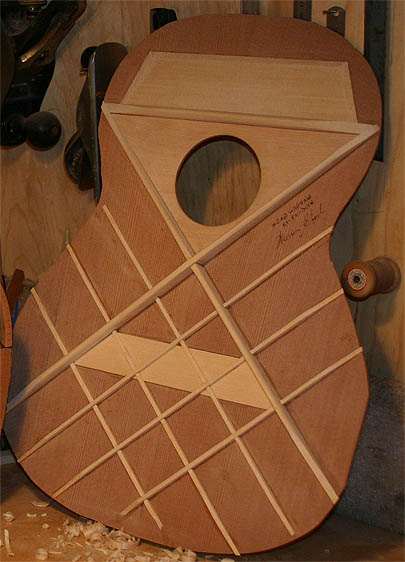

Here's a photo of the bracing I did on the guitar I built in my class with Sergei:
Here's what the top looks like from the outside:
This guitar has a sitka top and black walnut b & s. It is mid-sized, with a shape of Sergei's design (his "SS" - standard steel string). 65 cm scale. The sound gets rave reviews from everyone who plays and hears it. Not the biggest bass sound in the world, but a very nice, clear, defined, "piano-like" bass. Excellent mids and highs. Very lively, colorful sound. Good note separation. It does everything it's asked to do. It just LOVES to sing, and does so with gusto, fortitude, and spirit.
