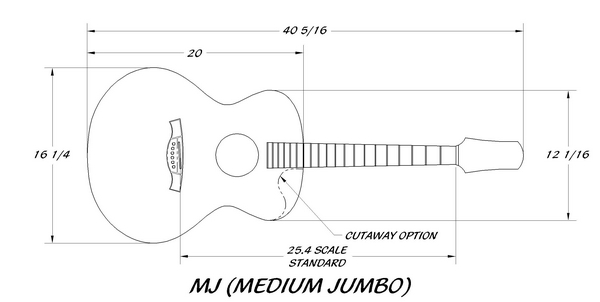

OK I have the MJ plans ready to submit to Lance for inclusion in the library of plans. I am going to proof them tonight and email them to Lance in the morning. It may take a few days or so for Lance to get them up on the site but they are ready to submit. I think you will like this one
This is not the plans

Nice, Michael. Thanks for such a fine design and for your time in making the plans available.
What is the history behind this model? Also...what is the specified body depth? TIA.
