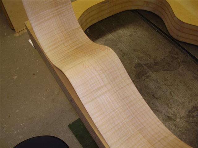

PostPosted: Sat Oct 13, 2007 11:58 am
James, if you havent tried the super soft II for beinding figured woods, you ought to give it a whirl. I just bent some curly maple sides for an OM cutaway with a really tight bend and it worked like a dream. I could almost bend the sides without any heat.
