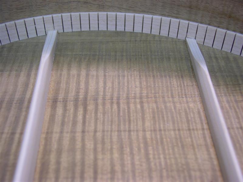

Whoops, I assumed that you were discussing the top.  For the back some builders do not inlet any braces although I think that most would/do.  They are sure to again taper them away to nothing to prevent stress risers.  The reason they do not inlet back braces is to promote the back's ability to slightly move and add a pumping action to the mechanics of how the guitar works.
If I recall correctly Charles Fox, one of the top builders in the world IMHO also does not inlet his back braces.
Here is an example of how some neat freak who is on this forum makes us all envious with his craftsmanship inletting back braces:
PostPosted: Sat Nov 03, 2007 2:02 am
Mmmmm, who could it be.....hmmmmm, let me think....maybe.....LANCE?
PostPosted: Sat Nov 03, 2007 2:10 am
Yeah, it's LK, but DANG you have to admit that's neat work.
PostPosted: Sat Nov 03, 2007 2:19 am
[QUOTE=Latham] I'm a guitar-making student in the UK and we're being taught to 'lock in' the struts/braces to the lining, so the final setup is that the brace extends almost to the rib (inside the lining) but is not glued to either lining or rib. The justification given for this is strength. Why would strength suffer if the lining were left un-notched and the brace shortened slightly to almost touch the lining? Would there be any other effects to taking this approach?
I think it would be a big mistake to inlet a brace and NOT glue it as it could become a rattle point.
