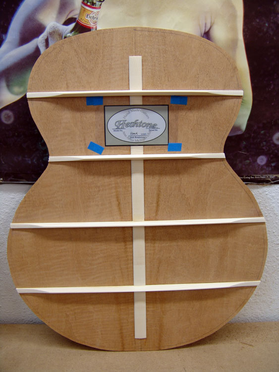

Robert I use finger planes for the vast majority of shaping and a sharp chisel for the ends.  To protect the back strip from the corners of the planes (the back strip is installed first in one piece) I place a piece of .005 mylar over it and then blue tape over the mylar next to the brace.  The planes just nicely then ride over the hump and the back strip stays neat.

Ricardo I use finger planes mostly for these triangular shaped braces.  But it starts with a center line marker that I use to scribe the middle of the top of the brace.  My brace stock is planed just proud of the height that I want so that the center line scribed indentation can be planed away as the last step.  Sometimes it takes me a couple of tries to get the slight amount of flex that I want in a back so I start taller and work down.
Here is a shot of the finished back complete with plastic cover over the label.

Hesh, I would be interested in knowing the dimensions of your braces?

Sure James - all four braces are 1/4" wide at the base.  The two longest braces located on the lower bout are 7/16th" high in the center and taper toward the ends to match the 15' dome of the back.
The two upper bout braces are 1/2" high in the center and also slightly taper with the back's dome.
I wanted the lower bout braces less stiff by design so that I can have a slight amount of flex in the lower bout.  The upper bout I wanted stiffer where the neck joins the body.  Just remember this is my thinking on the objectives that I am trying to achieve and I am not sure what will result so YMMV.
