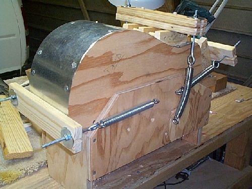

How do y`all fasten yor stainless steel to your fox-style side benders, and do you leave them on permanently? I am thinking about countersunk stainless screws, and have enough stainless for many different forms but am curious as to removing it for different forms. What do the rest of you do?

   Let me get it straight. Maybe I read too much into it when I did my research. Is there not a layer of sheet steel, then the wood being bent, the heating blanket, and then another layer of sheet steel to make up the complete "sandwich"? That`s the way I tried on the first try-out sides I bent and worked OK, but didn`t use stainless for fear of it not working and didn`t want to waste good stainless sheet steel. I am now going with the stainless for cleanliness and stability in the metals I`m using. The first metal I used was some left-over heavy gauge coil stock from my house siding days.

I use a heat blanket no bulbs. Bender (form), wood, steel slat, blanket.
It's at least 6 inched wide so the nails are away from the side being bent.

There is more than one way and like John How noted about the wood support. I like the sandwich method. This will actually support the wood when bending. The layers of steel kind of act like a flexible press and add support to the wood .
    If you do want to attach the steel to the sides and you are using stainless steel or spring steel , be prepared to go through some drill bits. You should also use simialar metal as the steel or you can get some reactions to the metals you may not like.

That`s the way I interpreted the setup to be. The only difference is that I made the crank-down caul for the middle of the waist, with a spare (which I don`t leave attatched unless bending cutaways). I was thinking that if you use roofing nails, the heads might be a potential scratch hazard should something slip and slide when getting things lined up. On my prototype (and it was a much softer metal) I used my brad nailer w/18 gauge slight head brads so they would sink below the surface. Really had to hold my mouth just right to keep from shooting my brads through.

Here's a really neat set up that Mike Doolin uses that has the steel attatched to the bender. One day soon I'm going to get around to making one.
Doolin bender
Mike has some really useful stuff on his site.

Worked on getting my side bender rebuilt last weekend. Didn`t get quite done, but made good progress. I decided to go ahead and fasten a layer of stainless to my form, in addition to using the "sandwich" on each side of my wood for bending. The other two layers of stainless had to be brought down to .012" from .060". I was able to do this on my shop made thickness sander. For anyone considering doing this, let me warn you, Safety, Safety, Safety. Wear all protective gear to avoid injury! Leather gloves, safety glasses, and I even wore a leather apron in case the sander decided to spit the pieces back out at me. Be sure you have good abrasive cloth on the drum, and take light passes. Takes an eternity, but stay patient and determined.
