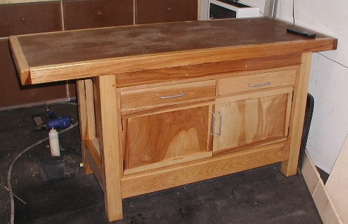

Ok, so it's not a guitar. But Hickory nonetheless.
My local hardwood supplier is going out of business and making deals right and left. When I went in to get some maple for this bench I found that he was pretty much picked over for maple but he suggested Hickory. He said it was MUCH more heavy than maple. I wanted weight so I thought what the heck. I started pulling out boards and he asked if I liked what I saw. "Sure," I said, "really pretty". He said that if I buy the whole stack (~200 bf) he'd sell it to me at cost. How could I pass it up. I figure there's got to me a good guitar back/sides in there somewhere. It's all 8/4 x 6-10" by at least 10 ft. My back still hurts from moving it all and that was a week ago.
Anyway, here's the bench. Pretty much my own design. Compiled from many other designs I've seen during my research. 3x3 legs, all 1 1/2" stringers, 1 layer of 3/4 baltic birch and 2 layers of 3/4 mdf for the top which is 24" x 64". The thing weighs a TON. Next week I'm building another one but will do something different with the cabinet below.

Looks good, Paul. How's it sound?

Paul - VERY nice and shows your a multi talented guy! But heck, your a Dad so we all knew that anyways
PostPosted: Fri Sep 30, 2005 10:49 am
Looks great Paul. I hope you built in the spot you plan to use it .

Very solid looking Paul. What is that maroonish center section made of?
PostPosted: Fri Sep 30, 2005 12:46 pm
John, are you talking about the top? If so, it's MDF (medium density fiberboard). Great stuff. Solid, flat, HEAVY.

Very nice work, Paul.

Yeah, but where do the string go? Nice bench Paul but what I really want to know is did you get any guitar wood out of the load?

Yeah, I'm sure there is some in there someplace. It's all flatsawn (which I'm not opposed to) but for the most part is really very clear. I'll probably dive into it a bit more next week and see what I've got.

Don't waste your time on flat of rift sawn stuff. It's not worth it as I'm sure you are already aware.
