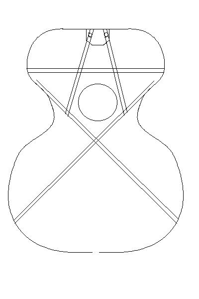

Here is how I do it.
I make my head block. It is important to put the 1-1/2 degree slope in the top part of the block. I slope the back part too but don't recall the angle at the moment.
On my table saw, I cut two 1/4" X 1/4" slots to accomadate the A braces. I use a wooden extesion screwed to my miter gauge so that the block is fully supported when it passed through the dado blade. I use a stop block to hold the head block in position on the miter fence. Since the stop block is placed by measuring, it is a bit of a hassle to get right so I make up several blocks at a time.
I slice these all the way through. When I mentioned this to Al, he said that he thought that having the A brace snug up against a stopped dado was important for the structure. You don't want the brace to be able to slide. Since my dado was not a stopped dado, I decided to put a stop in it. I drilled a 1/4" hole in the bottom of the dado at point where I want it to stop and glued in a hardwood dowel which I trimmed flush with the top of he block.
I make my A braces 1/4" X 1/4" X slightly long. I clamp the head block in its proper position on the top of the guitar with the A braces inserted into the slots. I then trace around the A braces. My A braces pass under the upper transverse brace and the upper X braces. Removeing the head block, I glue the A braces down onto the top. These are the first braces I glue down. Next I notch and glue the upper transvers brace. I notch the upper part of the X braces when I glue them as well. Once X is glued down, I trim the A braces flush with the side of the X brace.
The A braces also serve as a way to align the top with the head block. This was an advantage that I hadn't considered and only noticed when glued the top the rims.
There is a slight change in the depth of the dados in the head block once you sand the rims. A bit of chisel work while fitting the top cleans it up nicely.
Here's a hand drawn sketch of my pattern.:

That's beautiful looking work Mattia. Wow!
   Looks incredibly strong. And very neat as well!
thanks for sharing it .A picture worth a thousand words.
I included a bottom foot on mine. I don't know if it will assist all that much,but it must help a bit.
I'd be interested in how you go with letting in the headblock.Everything has to lign up perfectly. the transverse brace join, the headblock pockets,and the headblock angle in relation to the body and neck.
Having now completed one ,I think next time may be a little easier...........I hope

If you look at Mattia's picture (thanks!) you'll see that the chin is wide at the sides and tapers down to about the same width at the end as that of the fingerboard. Thus the edge of the chin does not run along a sinlge grain line, and it's less likely to crack.
One other thing, Mattia: where's your patch across the junction of the X brace?

Thanks for the kind words!
As for making it, I don't have an elegant way to do it worked out yet. I carefully line everything up, carefully clampe in place, mark the intersections, use a pencil cut /chiseled in half lengthwise to sorta mark the edges on to the chin, and route/chisel/test fit until it fits nice and snug. I'll probably make a small jig for the next few, to cut both the notches in the upper transverse and the headblock more precisely, but I'm not quite sure how yet.
[QUOTE=Alan Carruth]
[/quote]
Added that later, just like the little diamond center seam reinforcement patches ;-)
That photograph's got the top test-fitted and held by clamps, not glued in place. Although to be honest, I keep forgetting to put the patch in before gluing the top to the sides. Lucky for me I do that first, I suppose :-)
