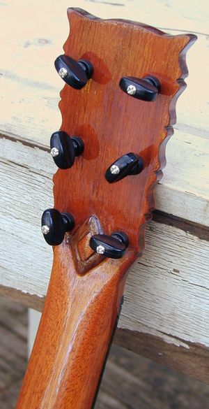

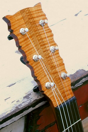

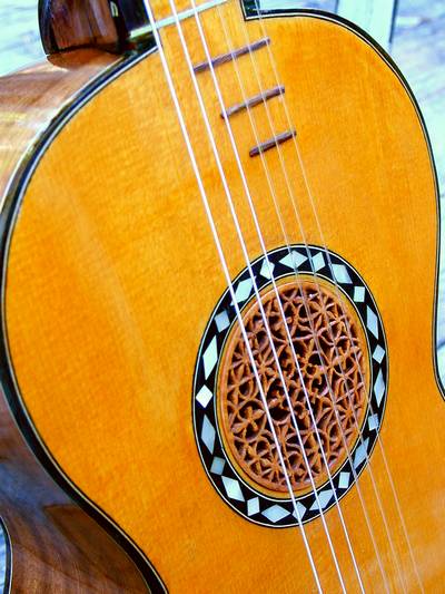

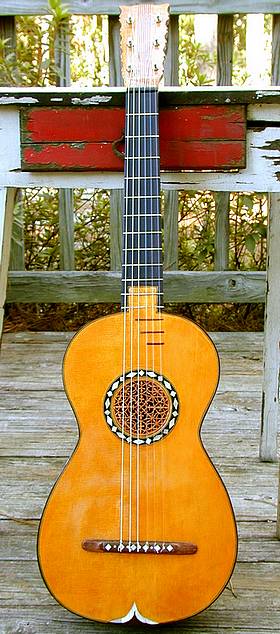

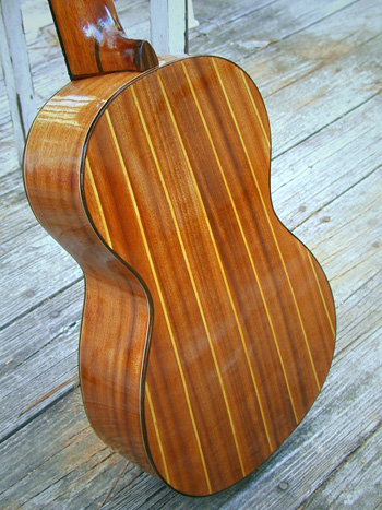

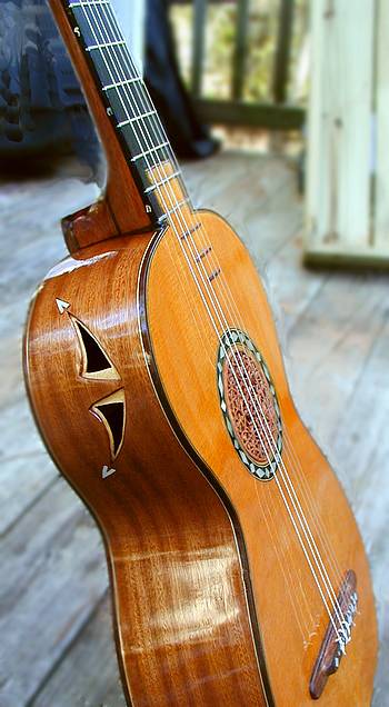

Here's my recently finished #2. It's a VERY loose copy of an early 1800's Martinez classical. I made copious stupid mistakes & it took way too long - 8 months. You fine people on this forum have been a great inspiration & help in the long & difficult birth of this project. Thank you for all of your generous sharing of experience & knowledge.
Anyway, here's the long & short:
Engleman spruce top (spray-dyed)
Sapele back & sides
mahogany neck
bois d'rose fingerboard
maple peg overlay & rose
Madagasgar rosewood bindings
Madagasgar frets (just the three on the top)
Indian rosewood bridge
24.75" scale
This little guitar would irritate a traditionalist. The neck bolts on and the construction methods are modern. I know the plastic & metal uke pegs are not typical of a 19th century classical but I can always buy a peg shaper & reamer later. These were MUCH cheaper and they work great. This is not a client guitar - it's for my own use.
The rose is a press-fit piece of maple sawn & carved & sanded into shape. The sound port on the upper bout sounds very nice & present. The bridge is typical of a lute-style bridge - it has no saddle so the tension is all longitudinal (parallel to the neck). As a result, this guitar has an overall soft voice that's more attack than sustain ... typical of (you guessed it) a lute. I like the sound but I wouldn't suggest it for concertizing. Nice bass for such a small body & kind of soft "plunky" trebles.
The back is a regular two-piece but has shallow grooves that are filled with gold acrylic paint, then finished over. I like this look, sort of a faux multi-piece back.
The back is ladder braced. The VERY thin top has three fan braces in the lower bout & ladder braces above & below the soundhole. No bridge patch as this uses low tension strings. The plan was found in GAL's Big Red Book #3.
The finish is Minwax wipe-on polyurethane (very non-traditional) that is yet to be polished & buffed out. I'll wait a few weeks.
All in all I like the sound & the vibe of this little fella. Now, on to building # 3 !!
Thanks for looking, I welcome comments and/or questions of any kind.

Skip, that is really a cool looking guitar. The soundhole rose looks great! I like your side port design, much better than a plain round hole.
I guess I like everything about it. Nice job!
PostPosted: Sun Oct 16, 2005 9:17 am
Looks good. Very interesting elements, I've never seen frets done that way. I like the peghead shape too.

Who cares if its not completely traditional....it looks great . This is YOUR guitar and YOUR design elements, thats what sets builders apart from each other. I also like your side ports and the back really does look like multi-piece. It kind of threw me for a loop when I saw the soundboard inlayed into the fretboard but with low tension it will probably never need a reset anyway (maybe this is the answer to setting the neck angle. Keep it up Skip, I'm looking forward to seeing the next one.

Great Job Skip!! That fretwork on the soundhole rose looks like a ton of work. The entire instrument looks wonderful and as Don said, it will help having a few of those types of instruments around when you start selling traditional instruments, they keep people curious!

The rose has certainly got me in!

WOW! Beautiful original design....very impressive.

Skip, Great work I just love it. Aren't these old style instruments fun they seem to have much more character than Martin clones. I can't believe it's only your second guitar, I wouldn't have had the courage to do that for my second!
The rose is great they are very satisfying to carve aren't they. The traditional wood of course for fitted-in roses were the fruit woods Pear, apple etc with a parchment layer underneath, but I see no reason not to use maple.
I don't think it matters that it is a bolt on neck many of these old guitars had pegged or screwed on necks and this is just a modern version of that. Ladder bracing with fans below the bridge in the lower bout goes all the way back to Venere in at least the latter part of the 17th century and has stood the test of time it produces a very sensitive top.
Multi piece backs are easy to make and can often be made with the offcuts when larger backs are trimmed. With a contrasting veneer sandwiched in during gluing they are as strong as the usual double back. That's the way we make lute backs, except they are made on a form and each slat is bent individually and glued onto the next slat with the veneer in between.
Please though change the tuners! Nice fruit wood pegs would make this really look great and they are very easy to make and install. Have you tried Nylgut strings for it? they would give it a very authentic tone.

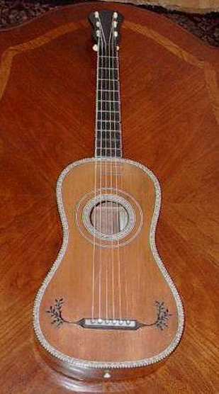

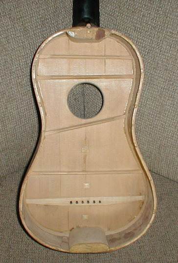

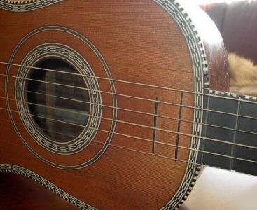

Skip, I knew I had some pictures on my laptop of this one.
It's probably English made about 1780 so only about 20 years before your type. I was lucky enough to be able to help with the restoration of it a while ago. It sounded fantatstic when finished no doubt due to the 220 year old European spruce top!
As you can see compared to your's you have really succeeded in capturing the essense of the age.
ColinColin S38642.5122800926

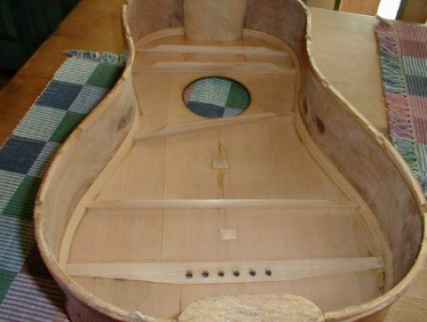

That's a lovely old baroque guitar. Yes, I'm sure 220 year old European spruce sounds very smooth & sweet. I'm curious about the bridge on this instrument. It is obviously a pin bridge. Did it have a raised lip on the front edge acting as a short saddle? I'd read that bridge saddles were not typically used until the early 1820's - the beginning of the "Romantic guitar" age. Lutes, earlier baroque guitars & vilhuelas mostly used tie-on bridges with no saddle or saddle-like ridges as I understand it. The bridge patch/brace is an interesting functional combination too. I'd love to hear that beautiful old guitar sing!
Thanks for the string link & the peg tuner encouragement. I will definately try real wooden pegs soon. Right now my guitar has LaBella 2001 light tension strings - nylon & silver wound cord. They're OK but I will certainly look into your string recommendation!

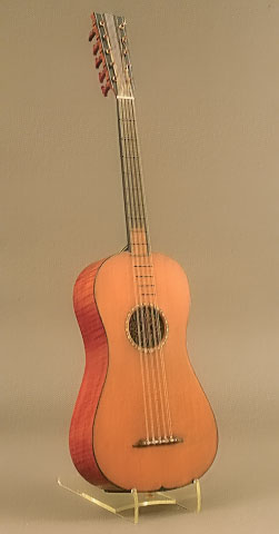

All in all I'm glad that so many people seem to get the intent of my newest instrument - trying to "capture the essence" of guitar building in an earlier age. Thanks for commenting. Also, here's a picture of the Rawlins Strad used as a design inspiration ...
