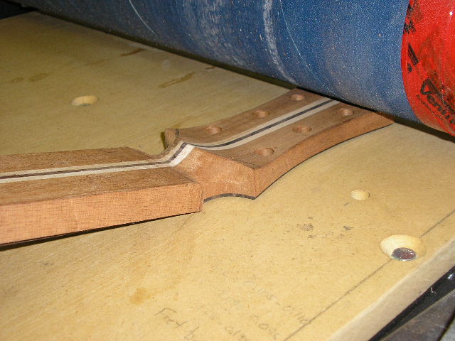

PostPosted: Sun Oct 23, 2005 3:58 pm
I agree with Tracy and the "if you've cut the 14th already, you have to remove thickness from the back of the headstock" statment.
If you have a thickness sander, drum style is what I use, you can thickness the back with it. Just run the backside of the headstock through the sander till you get close to your thickness, now finish it off with some finer paper and your done. Also helps make the nice "smile" volute which some of us make.
Here is a mocked-up pic of the process.

The "Luthiers Friend"...attaches to your drill press and does a great job of taking off as much or as little as you please. OFF THE BACK is the way I'd go.
PostPosted: Mon Oct 24, 2005 6:16 am
Dang Todd, that's a good-looking start...I have a Walnut neck going out in the shop that was a "practice" one for the new shaft cutter and jig I'm making as well as the new headstock style...thinking now I might need to build a walnut SJ to go with it!

But like the rest of you... I would take it off the back. I built one of those contraptions that John Mayes shows in his videos and that thing is my new 1,000,001 use tool.
:-)Brock Poling38650.381724537
PostPosted: Tue Oct 25, 2005 12:58 am
We need to get these (the sander tabley thingy and the X-brace jig) into the Jigs/Tools section so we don't lose them again!
