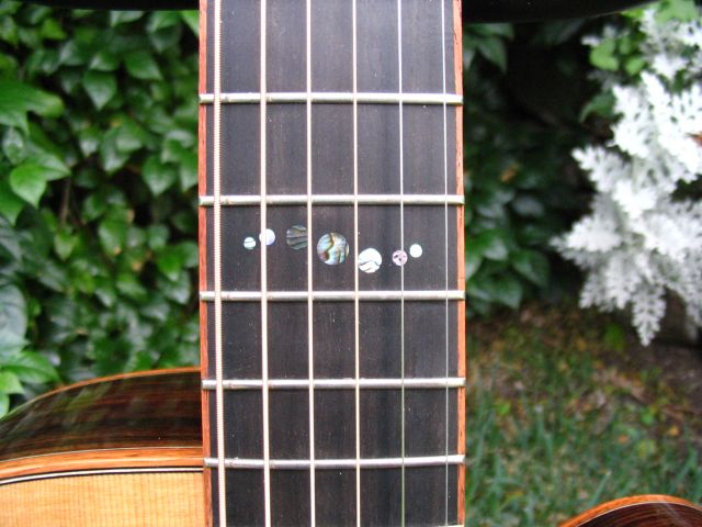

I ordered a bunch of stuff from the U.S. for a trial run of 4 mandolins that I'm going to have built down here and then export to the U.S.. I'm also working on doing the same things with guitars, and with the confusion of multiple orders from multiple places I realized yesterday I didn't buy any pearl dots for my mandolins. I've got abalone for the guitars, but they're much too big for a mandolin fingerboard.
So the idea came to me - why not cut dots from leftover quilted maple? The luthier I'm working with down here only likes to use wood binding, so there will already be a "different" aspect to these mandos...and I figured why not take the all wood thing a step further.
Anybody tried this or seen it done? I'm thinking that I'd need to cut a piece of maple as thin as possible, finish it, then use a forstner bit or something like that to punch out the dots. Am I missing an obvious problem? Would it not actually be necessary to have the dots be finished?

I made my own abalone dots by gluing small pieces of abalone onto the shank end of a brad point drill bit with some CA. Put the drill bit in a drill press upside down. Used a squared off sanding block with 120 grit on one edge to sand the abalone to the same diameter as the drill - on a low speed. Soaked the end of the drill bit in acetone for a few minutes, and popped the abalone off with a thumb nail. Then used the same drill bit to drill the hole to inlay the abalone into - perfect fit every time, any size you want, out of any material you have to hand.
