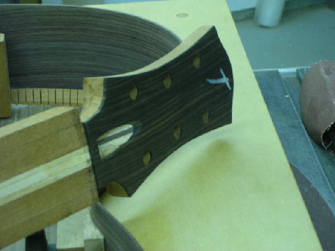

I run the slot through the neck after the head stock angle has been cut. Depending on the type of truss rod you use, you may need to cut/drill a channel for the truss rod nut. I use a gibson style, single rod truss rod and need to cut the channel like this

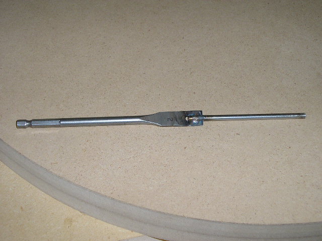

This is the tool I had made to drill the channel

Rod: thanks for the pictures.
It looks like you drill after applying the headstock veneer since it has the same channel appearance as the headstock beneath. What does the rod portion of your custom bit fit into? I have been using the double action truss rod that I buy from LMI. Tom

Tom, I drill the main channel in the head stock after I have glued in the spline over the truss rod (there is a thin strip covering on a single rod truss rod called a spline, don't know if you've ever used this), I than remove the truss rod (3/16"dia) and trim the spline to the same plane as the head stock angle. I than insert the drill into the exit hole of the truss rod slot and drill till I have about 3/16-1/4" between the headstock break angle and the flat portion of the drilled channel (hope that made sense). Than I glue on the veneer and after it is glued on, I drill a 3/16" hole through the veneer to the open part of the channel, I than redrill so the veneer matches the channel and it looks like it is all done in one step. The rod on the business end of the drill is a pilot for the bit, it runs in the truss rod slot in the neck, making sure I drill the channel on center of the neck.
Since you use a double rod, I don't know if you need this channel or not, I need it for the nut and washer on the truss rod end.
