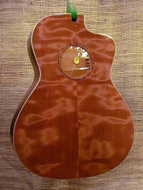

I've gotten a few tops from Bruce Harvie (here known as Spruce) a few years back. I've built a few guitars with them, octave mandolins, too. In fact all of the redwood that I have ever built with comes from this batch I got from him. So anything redwood on my website is wood I got from Bruce...
And I happen to be finishing a redwood/walnut L-00 right now, here's a shot for you. I used amber shellac on the top before the lacquer, I love the warm color. One of the checks that Bruce mentioned popped up on this top, but I used it anyway! I made sure that it'll be under the pickguard, if you look closely you might be able to see it. Oh, the Fatboy Guitar that I use for my avatar is also that same redwood.

I really like the green neck on this one, a little thin but a nice contrast.
