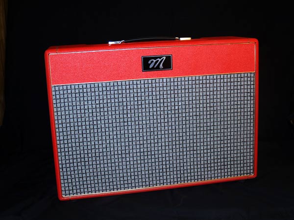

Fired her up about a week or so ago. Got a little ground 60 cycle hum to
chase down, but she sounds really good! Big, full and punchy.
John Mayes38743.7427893519

Is this a kit amp, John. Are you using this for acoustics? Tell us more.
PostPosted: Thu Jan 26, 2006 9:49 am

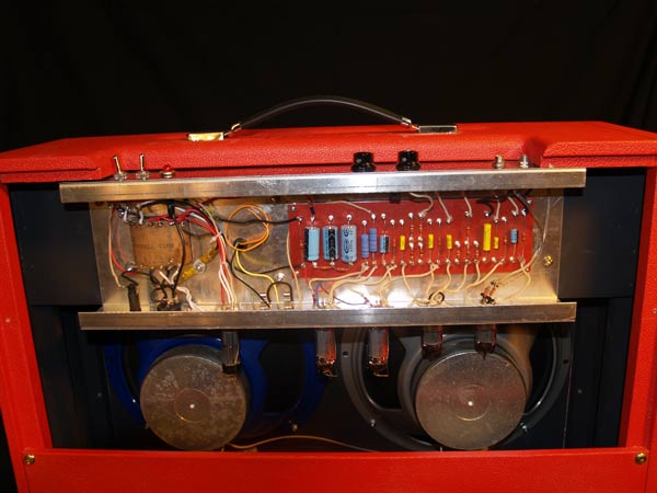

No kit. I did it all from scratch..... Well I did have the cab custom made
for me, but the chassis I made... sourced the components, made the
turret board, wired it up, and everything. Took me a while, but I finally
got it! And no for sure not an acoustic amp, but I did plug a acoustic in it
today. IT sounded ok. Really thick. But an electric rocks through it!
IT's an 18 watter based off an old 18 watt Marshall, but with the tremelo/
EQ circuit stripped out for simplicity. Has 2 12" speakers (both webber
speakers..one weber blue dog and one weber silver bell..great speaker
combo...speakers were custom made for me as well.). The tubes are two
12ax7's, two EL84's, and a EZ81 Rectifier. Vintage style transformers.
Mallory capacitors. John Mayes38743.7445717593

Man! That's awesome! The pic doesn't look like 2-12s, I thought at first it was 1-10 and solid state. Now that I know it's tube and 2-12s I'm all impressed. You must be stoked! Congrats!
Give us another pic w/ your guitar next to it. Really nice clean look. I'll bet she can wail.
Do you think you'll build more?
PostPosted: Thu Jan 26, 2006 10:45 am
I wish I could sit my guitar next to it! I have not finished building that
one yet. I borrowed a friends strat to test it out. I'm building myself a
LEs Paul Jr copy right now with Lollar P-90's.....Should be a rock n roll
set-up!

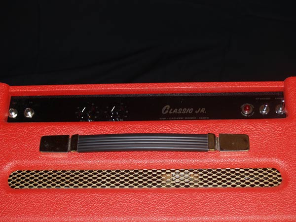

It is a large amp. About 30 inches across...for reference the logo plate is
4 inches across.
And yeah it ws very fun to build. I know I have a friend who wants me to
build him one as well.

John, This very cool. How about a schematic or is it secret? I've built some small preamps for special duty etc but this is very retro. I love it!
Who made the case, I thought it was production.
Steve Brown
PS always wanted to build a tube amp but never had the guts and the available kits are too expensive.
PostPosted: Thu Jan 26, 2006 1:34 pm
here is the schematic:
http://www.silvatone.bravepages.com/18%20Watt%20Lite%20II/Pd f/
18%20Watt%20Lite%20II%20Schematic.pdf
And the cab was custom made for me by these guys:
Reason AmpsJohn Mayes38743.8993518519

Nice amp John. Tubes are the way to go. On the 60hz hum
are the filamant voltages to the tubes AC or DC? Tried looking for the schematic on your link but couldn't find it. AC as a filament voltage will give you that hum and was a common practice in tube design.
PostPosted: Thu Jan 26, 2006 2:32 pm
Well I plugged it in at home and no hum...so it has to be my shop
building is not grounded well.
And yeah even though it is only 18 watts it is loud..really loud.
PostPosted: Thu Jan 26, 2006 2:42 pm
Posts: 409
John,
The grounding plugs have a little tab on the top, you unscrew the outlet coverplate, then put the plug in, and put the coverplate screw through the hole in the plugs tab and the coverplate. Screw in all in and the plug is grounded to the outlets metal frame and any metal conduit. Makes oldtime 2 hole ungrounded outlets into grounded 3 hole'rs. Cost about $.50 each.
