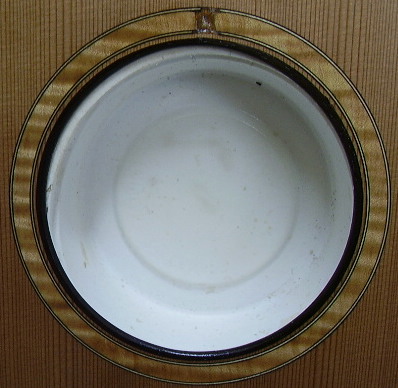

I agree Graham, the 3rd guitar I build had very little material between the rosette and the hole and I bound the sound hole, it wasn't that difficult and I think it looks good now.
Try not to look at the sour creame container though, I know it looks bad but the customer realy wanted it. Like they say, the customer is always right. Rod True38754.7129166667

Yup, that's what mine is, a scrap piece of side binding. Now you may want to thin it of course, so you don't have much sanding to do. And when you go to install the binding, think about the go-bar technic, I tryed to find a picture, I've seen it on the net somewhere, but just use some small strips to push the binding edge to the soundhole.

[QUOTE=Rod True]
Try not to look at the sour creame container though, I know it looks bad but the customer realy wanted it. Like they say, the customer is always right. [/QUOTE]
Looks like a potty.   I thought maybe you were using pee as an accelerator for hide glue and just didn't want to stain your label.
PostPosted: Mon Feb 06, 2006 3:26 pm
Nice Ron, No pee here. Besides, who (besides Mario) needs to accelerat hide glue.
PostPosted: Mon Feb 06, 2006 3:29 pm
[QUOTE=old man]Looks like a potty.   I thought maybe you were using pee as an accelerator for hide glue and just didn't want to stain your label. [/QUOTE]
That's one nice looking potty than, flamed maple edged in a thin bwb perfling. I'd sit my ... on there anytime, to bad it's such a small hole.... oh never mind.
I realy need some sleep.

[QUOTE=old man] [QUOTE=Rod True]
Ron[/QUOTE]
I think it most likely serves as a drool cup (necessary while viewing that great rosette!).
