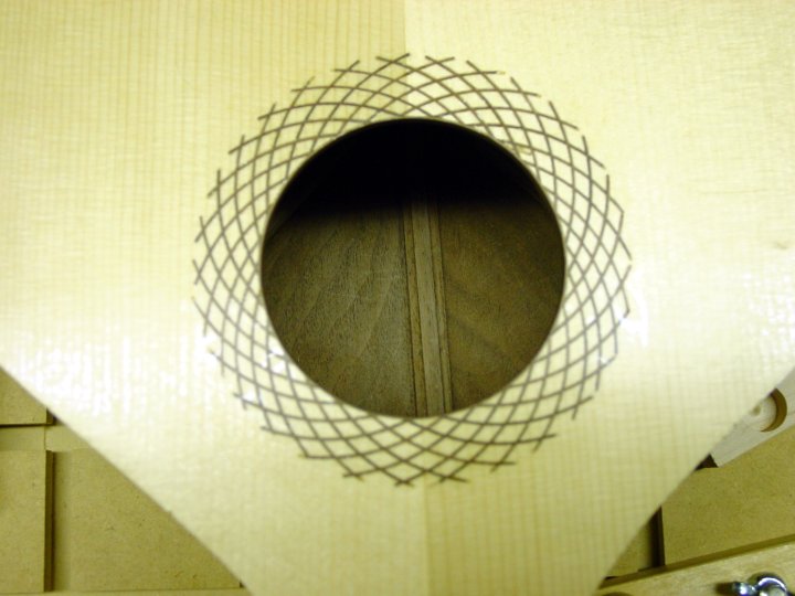

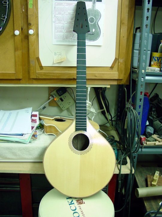

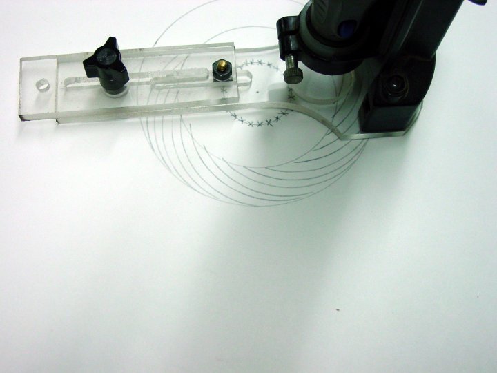

Several asked how Dan Fobert accomplished his spyrograph-looking rosette that was pictured a couple of weeks ago. I was looking at the LINT site and saw that Dan had done a pictorial of this very thing. It is indeed a spyrograph approach, and each of the lines is inlaid, not drawn. Here's the finished rosette:

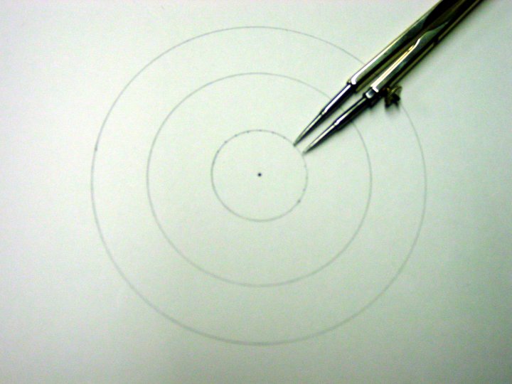

He starts by drawing concentric circles that define the inner and outer parameters of the rosette. Note the 1" inner circle with the pivot points drawn in at 4mm intervals:

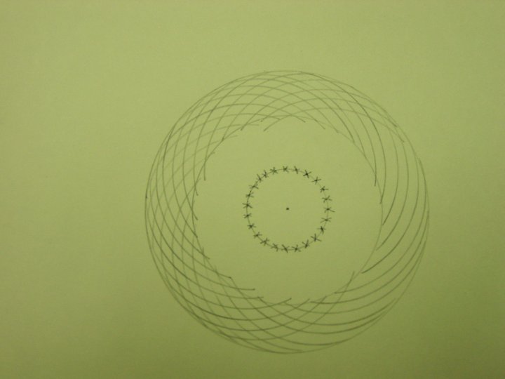

Next is a drawing-in of the router path based on those points, which shows what the finished rosette will look like:
And finally the routing:
Dan said that you could easily rout an outer circle to further define the outer circumfrence of the rosette, and tie up any "loose ends". That might give a little cleaner look, but then you might loose some of the spyrograph effect. He did use an inner band, which hides the backing glued to the underside of the top. Here's a shot of the finished instrument, an Irish bouzouki:
Hope you enjoy this, and if you try one, let Dan know you appreciate his sharing this info.

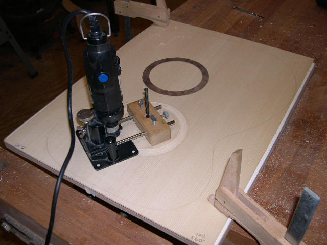

To use the StewMac circle cutting rig I'd think a special pivot would need to be make. Reading the original article at ling.org the author points out,
"Because of the closeness of the pivot points, a rose cutter was made with a pin-point pivot and adjusted to 1? inches between the pivot and the cutter."
I believe the StewMac pivot is 3/16". Now, I'm trying to figure a slick way to get a pin-point in the center of a 3/16" pivot. Maybe a 3/16" hardwood dowel, drilled accept a metal pin. Hmmm, sounds kind of dicey. Or perhaps, take a metal pin and slide it inside some brass tubing.
Any slick ideas on how to make a pin-point pivot for the StewMac rig? I'm sure lots of us have them.

PostPosted: Tue Feb 07, 2006 1:39 pm
Posts: 409
I 'may have' answered my own question. Got to thinking about 'common objects' with pins, right away thought of 'push pins', used for pinning stuff to corkboards and such. Turns out the ones I have in my desk drawer have a plastic head that has an approx. 3/16" diam. shaft. There is a molded collar at each end of the plastic head that has to be removed. Only remaining problem is length. Maybe epoxy the trimmed down push pin to the end of a 3/16" dowl. Guess it's time for a trip to Staples to look at push pins.
My other idea is to take brass tubing in diminishing diameters, one inside the other, starting with 3/16", until I can get one in the center with a compass needle inside. Trip to the hobby store for this one.

PostPosted: Tue Feb 07, 2006 3:31 pm
CrowDuck (now that's an interesting handle...),
My circle cutting rig uses a rosewood plug, glued into my "rosette board", which is drilled out to accept the metal pivot point. Admittedly mine is 1/4", but I don't see why something finer wouldn't work.
Here's the rig in operation-- the rosewood plug is buried under the top that is being routed, the maple holding block locks onto the 1/4" rod (ok, drill bit), and it's the drill bit that actually turns inside the rosewood. The only "slop" I get from this set up is the bearings in the Dremel. But that's another post....
Here's that plug:
Again, why couldn't you simply drill a finer hole--than I did here--for your pivot? It might work!

Thanks for the input, and nice looking jig. I guess the point of my meandering posts is 'how to use the StewMac rosette cutter' to cut that spirograph. Reading the original article at lint.org, the author specifically notes the necessity of a 'pin-point pivot, because the index marks on the inner circle are only 4mm apart. The StewMac pivot post is 3/16" od diam, and its bushing is also 3/16" id. 3/16" in. is roughly 4mm, so I don't see how how the 'stock StewMac' cutter could work without modification. So, what I'm really attempting to do is make a pin-point pivot that will fit in the 3/16" StewMac cutter bushing.
I guess another approach might be to fabricate a new slider arm for the StewMac rig out of plexi or lexan, and instead of a bushing for the pivot post insert a pin-point.
I've emailed the author of the original spirograph article requesting clarification about how he made the pin-point pivot. I'll follow up if I get more info.

Now that I see this, I am thinking up new rosette possibilities as well. I also just thought up a way to do this without modding the rosette circle cutter I already have very much a tall. What I am thinking is a second ring, with the diameter sl;ightly bigger than the one the author uses to mark out the 4mm spaced holes. This piece needs two holes, one a 1/4 inch for the main jigs pivot pin, the other 180 degrees away to locate the position of the piece for the pattern - my only hangup is how to secure the second smaller disc to keep the arcs smooth - still thinking ....

I had the answer to my questions; just tried to reduce the diameter of the center pin of my dremel base and had nice results. While doing this I also had some new ideas on different radiuses channels. I'll keep on experimenting and post picks soon.
