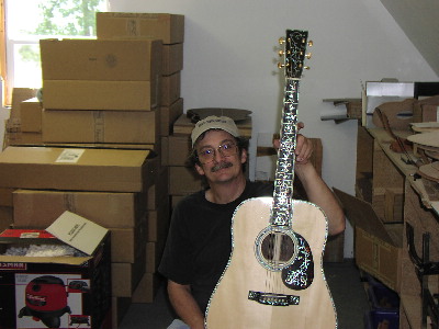

   If I am inlaying pearl on the top I avoid CA with a passion. I have seen it yellow spruce over time. Good oldfashioned Elmers is what Martin uses and I figure what is good enough for them is good enough for me. I havn't had a problem since.

Hey John,
Have I ever told you I love that guitar? Man, that's some work....have you sold it yet?

    This is one of my personal guitars that I use to show clients for a commision. Dave Nichols taught me the art and I have been doing alot with it.
     I have 6 started right now. 3 BRW 1 maple 1 quilted ZOOTMANS stuff with wild bearclaw and eir.
    Gotta keep busy.

That is one nice gee-tar.

I must clearify that I will use epoxy or CA on fingerboards and rosewood but never on spruce.
john
   Thanks again. The guitar took alot of pearl.
