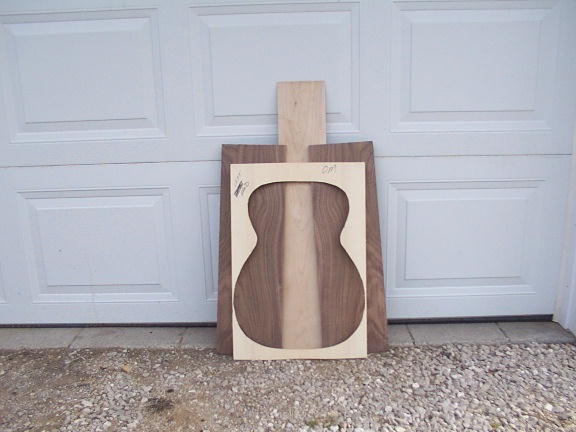

Hey Coe, do you have any pics of the pear wood, just curious of how it looks with walnut, must look great?

Serge, here`s a mock up of what may be...

Thanks a lot Coe, The pear wood is nice, first time i see it, it'll make a fine combination with walnut!
That's what my family name means in french!
Thanks bud!
