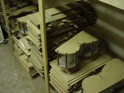

My store of top wood, my wife wonders why I have so much when I only build 4 or so guitars a year. I ask the same about her shoes!
ColinColin S38406.3698958333
