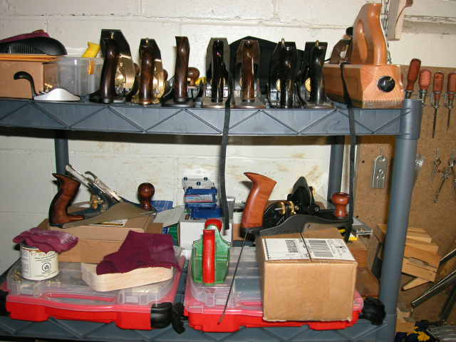

PostPosted: Sat Mar 11, 2006 1:40 am
Posts: 639

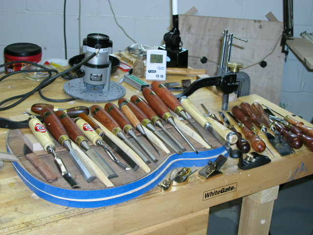

I think there are about 10-12 more not in this picture. See what I mean about guilt? I'm just as awful about chisels
PostPosted: Sat Mar 11, 2006 2:16 am
Mike,
What's so awful about being prepared?
I use planes on necks, fretboards, jointing plates, finger planes for braces and a scraper plane for thicknessing after the Wagner Saf-T-Planer. Not a purist either, just use what I have, tough I do enjoy using them when they're sharp and tuned up. A thickness sander would sure be nice, though. burbank38787.4288541667
