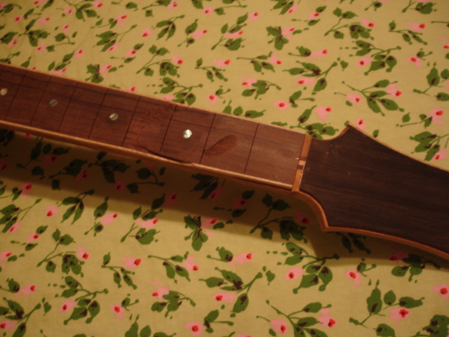

Well, it wasn't a shark but it sure looks like it!
A lesson well learned....never take your eyes away from your router
So here's what happened...I was routing my neck flush with the fingerboard, everything went smooth as usual...until I lifted the routed of the fingerboard, looked around to see the floor covered with shavings, when I turned to put the router down and as I moved my arm towards the table...BAM I miss judged the distance and I hit the fingerboard with the router still spinning.....well I guess t he pictures tell the rest of the story....
So I guess the best thing to do is remove the fingerboard and glue on another one.
I was lucky, after all the neck is still intact
Any suggestions for the easiest way to remove the fingerboard? It was glued with titebond yesterday..
Thanks again,

I put a towel down on a work bench, lay my heat blanket on it, clamp the neck to the blanket (face down of course) an in about 5 minutes you should be able to unclamp it and peel it right up with a putty knife.
You may then want to clamp the neck to a known flat surface while it cools. Just put a piece of wax paper down so the glue residue doesn't rebond to the clamping surface.

Thanks to Brock's advise I had the fingerboard off the neck and the eck cleaned in less than 10 mins! and to think I was going to use a clothes iron?
Thanks again...
