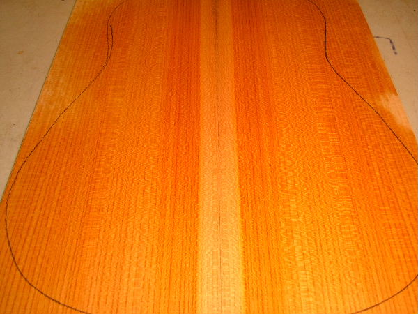

[QUOTE=tl507362] For those who don't know the english name of Keyaki, it is the Japanese Grey Bark Elm. Japanese use this tree for Bonsai. Very beautiful tree that can be very big. I didn't know it was used for guitars. Hmmm, learn something new everyday!
Tracy[/QUOTE]
I know of four species under the name Keyaki. In China and Japan it's a protected tree used for temple work. It is rare to find large timbers in the west. Most of the high quality stuff is veneered. Beautiful ringing tap tone. I'll have several sets at GAL.
That is one incredible Bonsai tree in the photo!!!!!
Larry Davis38796.7000115741

Larry, btw, how much is a set of Keyaki like the picture you showed? Ballpark is okay. Beautiful piece of wood!

[QUOTE=tl507362] Larry, btw, how much is a set of Keyaki like the picture you showed? Ballpark is okay. Beautiful piece of wood!
Tracy[/QUOTE]
Price is $90.00 and the set in the photo is available. The sides are cut from the same timber....side by side. I acquired several 15-18" wide 14' long quartersawn pieces several years ago. I'd be happy to make a phone appointment and tap some of these unique woods. Not high tech, but it gives some sense of perspective on woods not often seen in the stores. I can also email better quality photos.Larry Davis38796.8243287037
