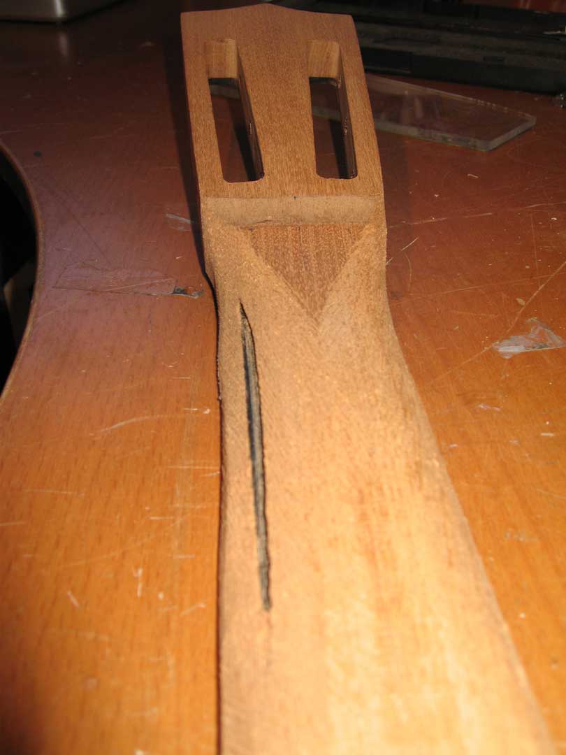

This was the first neck that I used carbon fiber rods. Well, I guess you just
cannot place them anywhere!!!!
The freboard was on and leveled via tape as described in a previous thread.
Removed and fretted. GLUED on. All I needed was to carve the neck. I do
this with rasps. Well WOOOOPS...I carved right into the carbon fiber rod!!!!!
I thought I was going to puke!!!!! I assume this is not fixable. I have already
used my heating blanket to carefully remove the fretboard. I guess it is time
for a new neck. I TOLD YOU SERGE I STILL DESERVE THE NEWBIE STATUS
UNDER MY NAME!!!!!

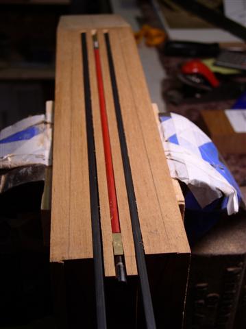

Andy, It seems your CF rods were a little far out from the truss rod?
I do mine a little bit tighter, or so it seems
What you might try to do is cut that neck in 3 pieces and glue it up with two color lam's right where those rods are now. Then reshape. Just a thought, probably more work than what its worth.

A few questions from your pic. What are are cross sectional dimensions of the CF? How far from the TR were the slots routed? It looks kinda close to the edge where there's less meat.
From the pic, (slothead) it looks like this is a 12 fret neck. I've only installed CF in longer electric necks and 14 fret acoustic necks. My rationale is that the shorter neck will be stiffer and may not require the addition of CF. I'm sure others will have better info.

Clearly my rods were to far away from the truss rod.
No it was not a 12 fret. Just a 14OM were the client wanted a slotted
headstock.

From your photo it looks as though the CF rods were not seated all the way to the bottom of the slots. Is that what is going on there? If so, in the future, you'll want to fill that void with epoxy before you put the carbon in. Voids in necks are not a good thing. If it's not a void, well then never mind.
