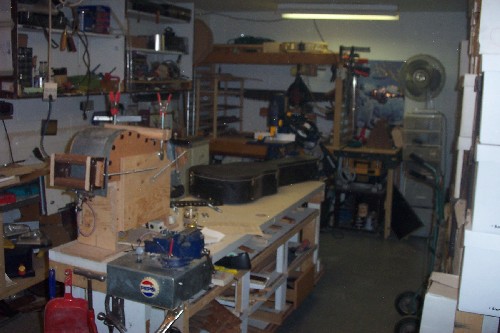

Thanks Michael, my bender is a mix of ideas but i can switch forms at will, my only problem to solve is the cutaway, but i have a pretty good idea of how i'll fix it and sure will follow your advice on the spring steel slats
I hope you can see what i mean in these 2 pics, i have 2 sets of springs and rounded cauls that should do the job on a regular shape,
but on a cutaway, i think that i'll either need threaded rods and wing nuts or build nyself some type of device like the fox bender has for the cutaway
