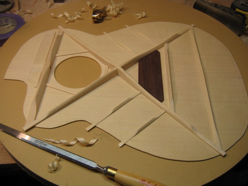

I have a convex bottom Ibex, the largest that Lee Valley sells and one size smaller than Stew Mac sells, I like shaving the side of braces with it it gives the braces a very graceful sweep that I find appealing. I am in the camp that likes braces a bit taller but a bit thinner near the top. Here is a picture of a braced top and the Ibex plane I use, this was before Mark sent me his beauties!
