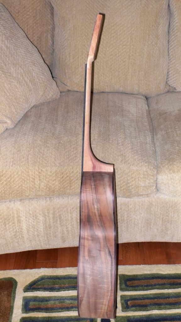

Hello,
Well, I've been trying to get a good fit between the neck and the body, and I am having a heck of a time. I've made sure the body is dead flat (top to back) where the neck sits, but as you can see below, I can't for the life of me get a good joint.
One side fits better than the other, and this may provide a clue as to what's happening.
Do you guys have any tips? Man, I'm taking a break for tonight.
Thanks in advance,
Pete

Are you using the floss method? Let us know what your method is and maybe that will shed some light on some advice.

Hey Pete;
It can be REALLY frustrating trying to get a good fit at this joint.
It's hard to tell from the pics, but the sides don't look quite flat to me. Use a good light source & a straight edge to check the body for flat.
It's way too easy to oversand the edges & end up with a big gap at the bindings. You have to glue sandpaper to a FLAT block to prevent sanding dips in the softer sections of the wood.
John Mayes makes fitting the neck look easy on his video using self adhesive sandpaper stuck to the body. The video is worth every penny!
Maybe he'll be nice & post a pic or two.
Good Luck, & don't lose hope!Daniel M38864.9025

Hi Paul,
Well, I was using the method I saw on John Mayes' video where a sticky backed piece of sandpaper (100 grit in this case) is adhered to the body and the neck is slid in and out, effectively transferring the body shape to the neck proper.
Unfortunately, after shaping the neck, I had the angle wrong (tenon cut by hand) and had to cut/chisel the relief angle after the fact, until it was close enough. Now,I can't seem to get anywhere close to a good fit. I'm back cutting the neck so only about 1/8th of an inch is contact with the body.
I may just have to approach this with clear head.
Pete

Posts: 79
Thanks Daniel,
I was composing as you posted. Yes, John's videos wonderful. I think I started to go wrong by not building a jig.
I will double check the flatness of sides, good point.
It may be a case of inexperience rearing its ugly head!!
Pete

Pete,
That's gonna be a nice guitar when you get it all together! Be patient.
It's clear from your photos that it's your heel that's not flat at this point. I can see undulations where it meets the body, on both sides. By all means, though, check that the body is flat and proceed from there. From what you wrote, it sounds like you had the joint right, using the Mayes method, before you tried adjusting the angle. Can you try that again? Just be sure you don't rock the neck while moving it against the sandpaper.
BTW, I don't think you can use the floss method here, because your fingerboard is already attached. You'd sand off much more on the bottom of the heel than at the top--great for a neck reset, but bad if you've got enough angle now.CarltonM38865.0018055556
