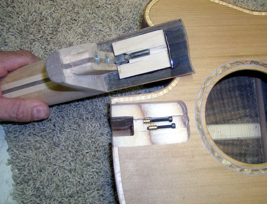

I thought I would give a short explanation on how I made the bolt on section for the fingerboard extension on my latest build.
First thing to do is have the neck properly aligned with the body.
Next, cut out the mortise and attach a block under the fingerboard extension.
This block supports the extension and adds thickness for the threaded inserts.
The #8-32 socket head cap screws (SHCS) and brass threaded insert are shown in the pocket for truss rod access.

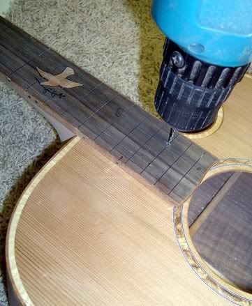

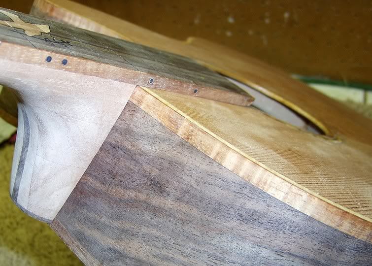

Next step is to drill holes through the fretboard and support black at a fret slot.
I used the 18th fret.
These small holes will be covered with fret wire.

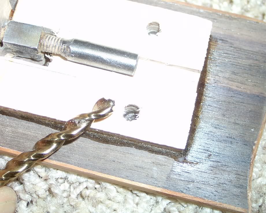

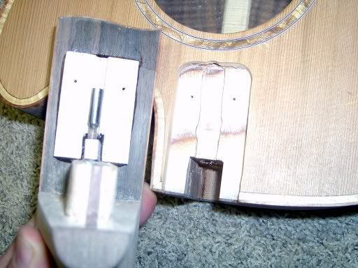

Remove the neck. Now you have perfectly aligned holes. Enlarge the holes in the guitar to accept the #8-32 SHCS.
Enlarge the holes in the fretboard extension block to accept the #8-32 brass inserts.
Use a brad point drill. Do not brill through the fretboard!
Screw in the brass threaded inserts and the job is done.
How's that?
(The truss rod is not seated deep enough into the neck.)
What do you think about using only 2 bolts?
Any thought and comments are welcome.
