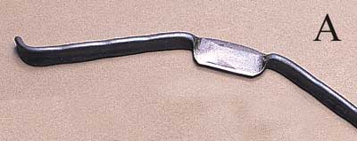

I like to use a draw knife for roughing out the neck shape on straight grained mahogany. It doesn't work very well on curly maple for example as you are splitting off pieces more than shaving, so you need to pay close attention to the direction of the grain or you can ruin a neck fast. I like to use it bevel down, and you can actually control the cut very well this way by slightly adjusting your attack angle by tilting the handles up or down relative to the plane of the cut. It is much faster than a spoke shave, which is what I use after the initial roughing out. Then it is on to rasps and sand paper. If you are very good (not me!) you can take it pretty close to finished shape with the draw knife in minutes.
Here is my draw knife, good old Swedish steel of course!
Svante Djaerv draw knife
<edit> I just checked my link, and it seems it only takes you to DICK's main page, and I don't know how to fix the link. Anyways, the draw knife can be found under "Carving Tools" and "Svante Djaerv draw knife". Here's a picture:
Arnt38883.6320949074

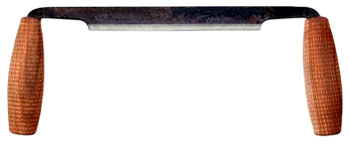

Drawknives and spokeshaves are among the tools I use for neck shaping (and other carving tasks). My favorite drawknife is a little one I got from Japan Woodworker. The smallest one they sell - it's called the "straight micro drawknife" from North Bay Forge. I love this tool. I also use a really nice handmade carving knife my wife got me for Christmas, in the heel area and the transition to the peghead. I also use rasps. On my next necks, though, I'm going to try doing a lot of it on the belt sander. Not the old world craftsman way, I know! But I know some builders do most of it on a belt sander really fast and I figure I'll give that a try.
Todd Rose
Ithaca, NY
PostPosted: Wed Jun 14, 2006 8:17 pm
Posts: 2687
Here's a pic of this awesome little drawknife, taken from the Japan Woodworker web site. The blade is maybe an inch and a half long.
