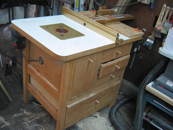

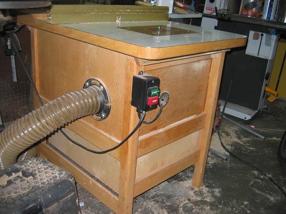

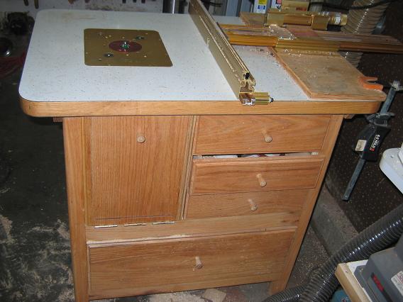

I put a lot of time and thought into my router table, and I have been very happy with it. For what it's worth, here's my experience.
I decided that I was willing to invest around $750 in a really good router table set-up, minus the router. Ultimately, I spent $250 of that on a Woodpecker PRL router lift, about $225 on an Incra fence system, and the remaining $275 or so in materials for the table itself. For the actual table top and base, I made it all myself, so the $275 went a long way. It's the sturdiest router table I have ever run across, and it makes even the most expensive commercial models I have seen feel like toys.
Here's the finished product:
I found that two things were very important in building the router table: (1) a top that is flat and will stay flat despite holding a heavy router and lift, and (2) a very substantial top and cabinet that will eliminate vibration.
My router table top consists of two pieces of 3/4" baltic birch ply laminated together, then banded with 1-1/2"x1-1/2" oak. Then I glued a piece of formica (a cheap leftover scrap from the local builder's surplus store) to the top and the bottom, and chamfered the edges to reveal a bit of the oak. Underneath, I have additional 1-1/2" x 1-1/2" pieces of oak that stretch along each edge. It is still dead flat years after construction, even though I use a heavy 3-1/4 HP Porter Cable router and a fairly hefty Woodpecker PRL lift.
The base is a cabinet built from 2"x2" oak with 3/4" baltic birch ply for the back and sides. Drawers on the front with pretty slick ball bearing drawer slides (included in the price I mentioned above).
The router sets in its own enclosed section of the cabinet with a dust collection port made out of a toilet flange. I put a safety switch from Rockler on the outside so I don't have to reach inside the cabinet to turn the router on and off.
Modesty aside, this router table is awesome. The only thing I'm not enthralled with is the lack of a dust collection port on the Incra fence; my only DC is under-the-table, and that doesn't get everything. But it does pretty well, and one of these days I'll get around to doing something about the fence.
If I were doing it again, I'd probably take it a step further by building my own fence. The Incra is a great system, but more than I need, and not great at dust collection. Also, Woodpecker has come out with a new lift that is cheaper than the PRL and has a fantastic quick-lift feature. I don't remember what it's called, but I would definitely get it over the PRL if I were doing it again. (The PRL is a great lift, though.)
With regard to the top, I don't know how sturdy a phenolic top would be. The Lee Valley steel top will obviously stay flat, but it's really not necessary to spend that much money since it's so easy and cheap to build a really sturdy top. I'm also not sure how easy it would be to install the lift of your choice.
Of course, if you would rather spend more money buying a router table so you can spend more time building guitars, that's a legitimate approach too. But don't expect to get anything as sturdy as what you can build for a lot less.
