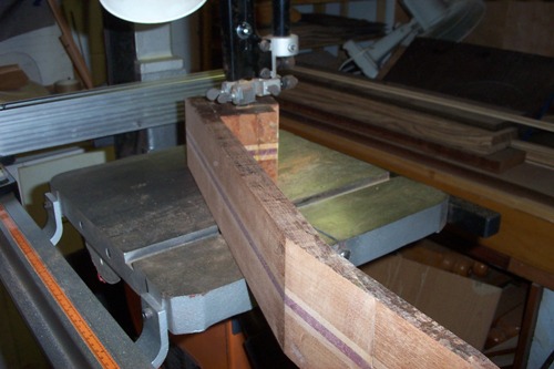

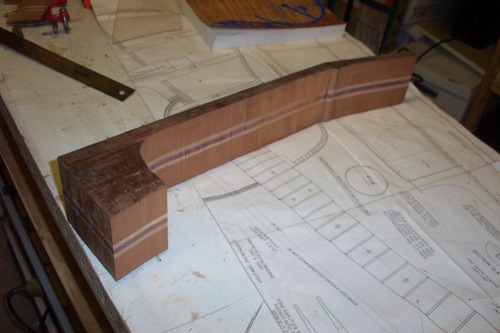

Yep, being on vacation helps a bit, today i made myself a plexiglass template for the neck profile and used it on my neck blank to draw the outline, i then cut the blank on my bandsaw.

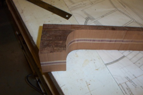

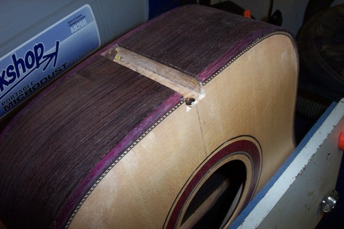

I cut the entry for the tenon on the top.

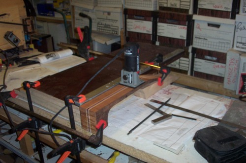

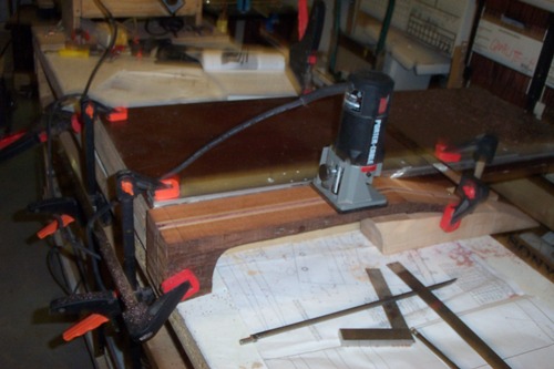

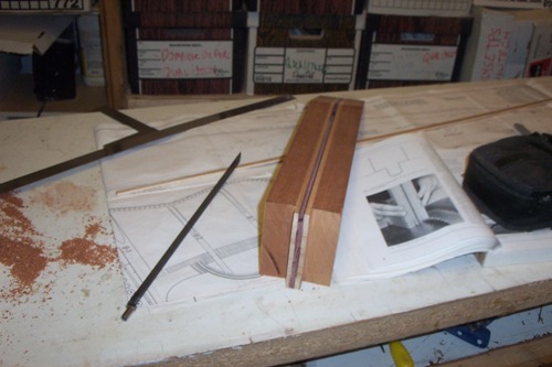

Routed the channel for the truss rod, check the set up made with boards and clamp everywhere, it worked well but i'm sure there is a simpler way of doing that, i'll probably start a thread just to see your setting up

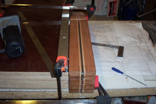

To the left of the neck, there is a thick aluminum straight edge that i used to cut the straight channel, my router was leaning against it.

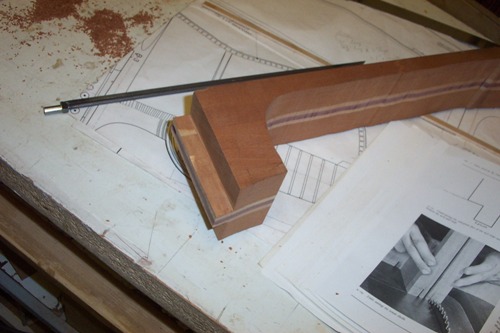

And finally, i cut the tenon with the table saw, lots of remeasuring to make sure the depths were acurate but it paid off, it went really smooth.

I too like the five piece neck. I optioned not to cut my tendon on the bandsaw. I couldn't get my head around the idea on how to cut it on a 5 deg so the the neck angle would be close enough to fudge with chisels and scapers. Did you just cut it on a 90 deg and add the 5 deg later?

Thanks Clinton, you probably mean 1.5 degree angle right? if so, you just have to use a protractor and draw your line on the side of the heel but for some reason, i did not have to do this, my angle is spot on 1.5 so maybe my fence was a little off and i was lucky!
