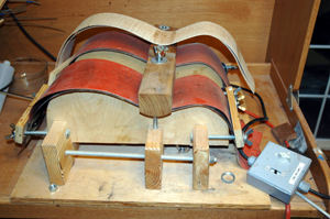

I think the stew mac one was well worth the money. It works great. But I agree my primary bending rig is the machine with the heating blankets. I made a double jig so I can bend two sides at once.

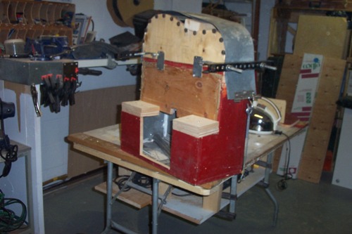

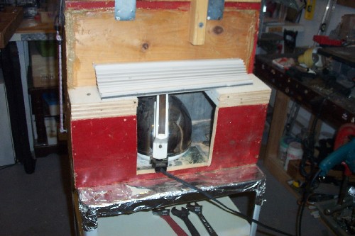

Martin, i was in the same situation last year and used a kettle and steam chamber to bend my sides! Here's 2 pics of my first and now former bender, while it was in the making! I can relate.
