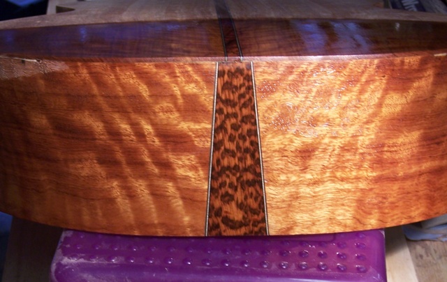

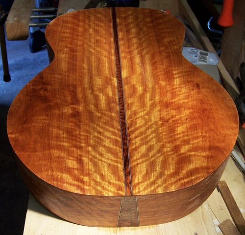

Well the next commission is under way so here are a couple early pics
PostPosted: Mon Jun 26, 2006 3:28 am
WOW WOW WOW Michael, this is gonna be another fine lookin'!

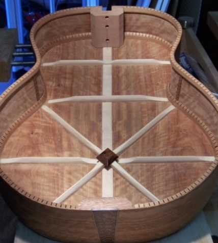

PostPosted: Mon Jun 26, 2006 8:20 am
By the way boys and girls this is the change I made to the OLF SJ back bracing from X to Star-brace, that I spoke about a month or so ago on the OLF SJ. The Star gives the big round lower bout better ach support. The Star braces are .3125" wide x .625 tall. The X portion is nothched jointed and the laderal fingers taper to nothing just short of the X

Love the snakewood, it's my favorite, smells like cinammon when I cut and sand it :)

[QUOTE=MichaelP] By the way boys and girls this is the change I made to the OLF SJ back bracing from X to Star-brace, that I spoke about a month or so ago on the OLF SJ. The Star gives the big round lower bout better ach support. The Star braces are .3125" wide x .625 tall. The X portion is nothched jointed and the laderal fingers taper to nothing just short of the X[/QUOTE]
Michael, I have a couple of questions. First, where did you get the narra? that sure is pretty wood.
Second, did you change the angle of the X at all in this version?
I'm just starting my first SJ build. I can only hope it turns out as nice as yours.

I agree Todd, but the SJ is just a bit larger than an OM. 15.5" lower bout and 19.94" long body so it is an in-betweener. Comparing ladder to x bracing is hard to do but I fell it allows the back to resonate free but still provides structural stability using lighter bracing. Most ladder bracing I have seen has been 3/8-1/2 x 5/8-3/4 tall My star and x bracing is 5/16 x 5/8.
Original x brace for the SJ worked good but the dome seemed to flatten near the apex of the lower bouts on the SJ due the large radius of the lower bouts. I added the lateral fingers to help maintain the dome shape of the back better, but I did not want to reduce the movement of the back much so I did not tie the lateral fingers into the X and tappered to nothing short of the X

[QUOTE=WayneC] [QUOTE=MichaelP] By the way boys and girls this is the change I made to the OLF SJ back bracing from X to Star-brace, that I spoke about a month or so ago on the OLF SJ. The Star gives the big round lower bout better ach support. The Star braces are .3125" wide x .625 tall. The X portion is nothched jointed and the laderal fingers taper to nothing just short of the X[/QUOTE]
I'm just starting my first SJ build. I can only hope it turns out as nice as yours.[/QUOTE]
I got the Nara from Zootman and yes the X in this version is a 90Deg X. If you change to a 90deg I would most certinly add the laderal fingers to support the dome in the apex of the lower bout

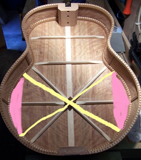

PostPosted: Tue Jun 27, 2006 4:01 am
I thought I would share with you that are building or going to build off of the OLF SJ using the X back bracing, why I changed by X brace to a star. In the pic the pink is the area that seemed to flatten out or loose its dome shape. Now I am talking very slight flat not major flat the yellow is the approx location of the x per the OLF SJ plans at 70Deg across the bout. The change to 90Deg makde the spread wider but to eliminate the flattening I added the laderal fingers to maintain the dome.
MichaelP38895.5946412037

Good work and good thinking, Michael. When you said you changed the X to a star I thought you meant X the other way--with the acute angles on top and bottom. My X braced backs have the tops of the X going up a bit higher than on your star pattern, so that the top and bottom angles are slightly acute. But 90? makes sense if you are thinking of the lower bout as a passive woofer. I begin my taper to the sides further in, to get more compliance around the perimeter; in that area (with a few inches of the rim), I see the bracing as there not to provide stiffness, but just crack resistance.

Thanks Howard! So your saying to start the taper closer to the center and allow the perimiter more freedom. Next one I will do just that.
