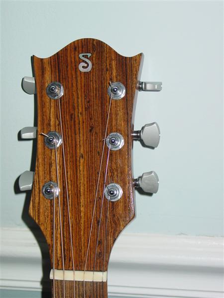

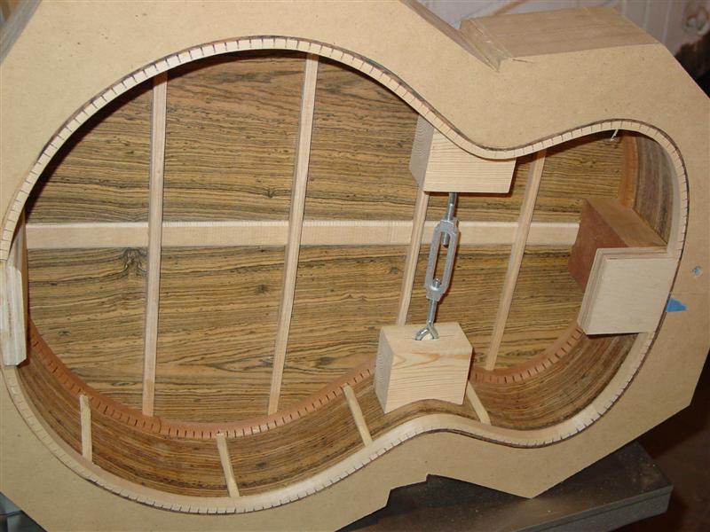

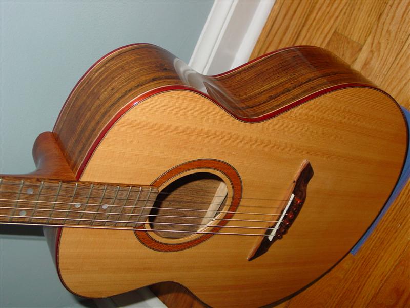

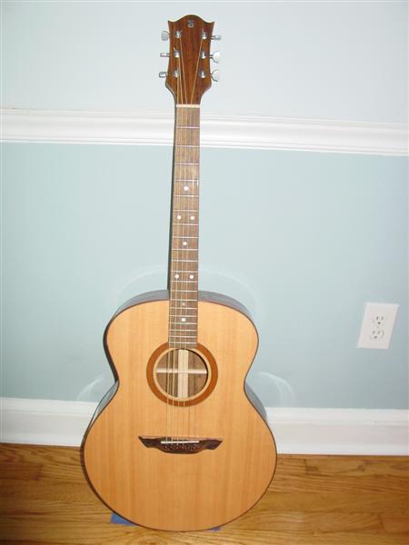

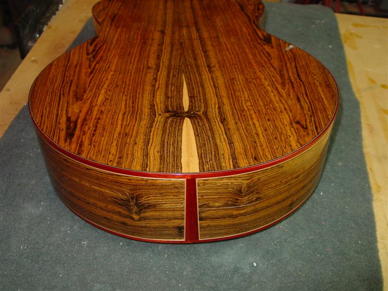

Well, this guitar was sort of an experiment. It is an OLF SJ and full of mistakes, but I decided from the outset that I wouldn't spend too much time trying to correct them. I mainly wanted to see how the bocote and douglas fir top would effect the tone of the guitar.
It turns out that this guitar is the sweetest sounding out of the 3 that I have built, and has really great sustain. It sounds similar to cedar topped guitars I have played but the highs seem to have more "shimmer". The only drawback is that the top starts to break up a bit with hard strumming - this is definitely a fingerstyle guitar.

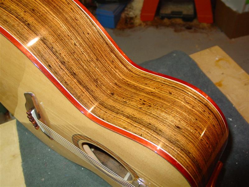

I'm still not sure how I feel about the Bocote. Since I've finished the guitar there have been numerous cracks popping up on the sides and back, and I also had trouble with the sides cracking during construction. This might be a result of the sides getting thinned too much when I was sanding, but I didn't expect it to crack after the nitro was on there.
Anyway, here are the specs:
Top: Douglas Fir
Back/Sides: Bocote
Binding: bloodwood
Rosette: Leopardwood
Neck: Leopardwood/maple/bloodwood
Fretboard: Bocote
Bridge: Ziricote
Finish: Nitro
-Karlksudar38895.7731481481

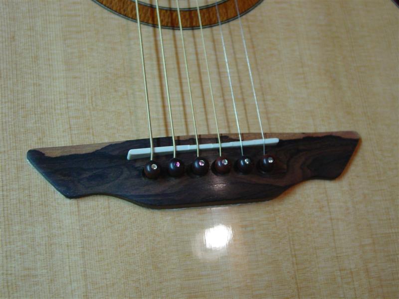

Very beautiful guitar Karl, excellent craftmanship and great taste in bridge design!

I wouldn't take that to mean all Bocote is going to crack just like all Ziricote or all Brazilian RW doesn't crack. I have bent Bocote sides without cracking. Probably just that particular piece of wood. It is very beautiful.

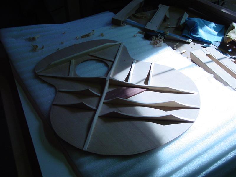

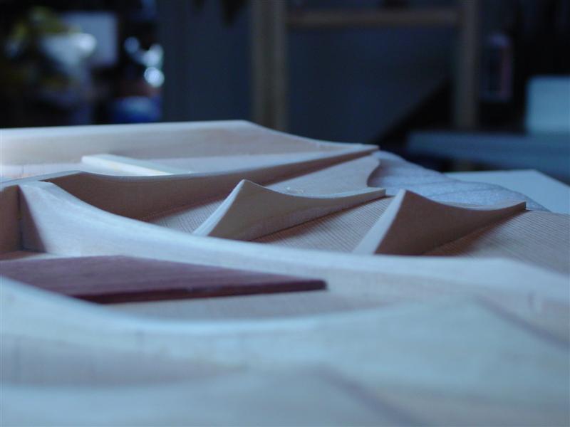

Nice clean workmanship (you DID cap that X-brace joint after the picture was taken, right? ; that's what your get for taking such clear pictures!)

    That Bocote and D. Fir are awesome! I really like your bridge design and the bloodwood bindings are outstanding too. Beautiful!

WOW! That bloodwood looks fantastic along side the bocote! Nice work!

Thanks for all the kind words!... and yes I did cap the X-brace! I wish I could post some sound clips but I don't really have a good setup for recording - I'll see if I can come up with something in the next few weeks.

The funny thing is that I just started my first commissioned guitar, and the client saw this bocote and wanted the same wood for his back/sides. So I'm a little nervous about using the bocote now, but the set I'm using for his guitar is much more stable than the wood I used for #3. That wood came from a hardwood dealer and I have doubts about the way it was dried.
