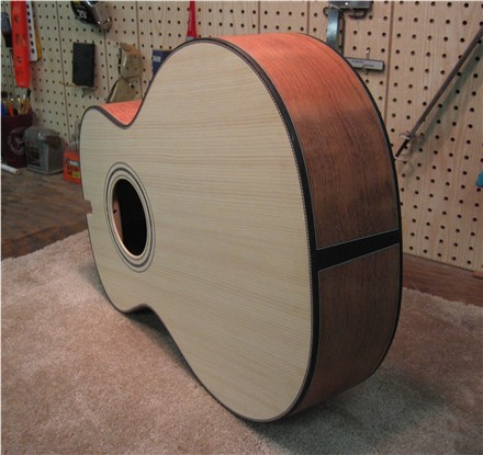

Hi Jeff, All great advice from the guys, purfling first and then binding! If you're not sure about purfling in the back, just have a look down here, i did not use herringbone but it was roping that i put on the top and on the back and as a center strip for the back also! It's just a suggestion, i'd really think it through if i were you and weigh all the options that are available to you out there!

Hi, Thank Jeff, it's EIR back and sides with Lutz spruce top and yes, i forgot to mention that i use a laminate trimmer for the purfling and binding channel!
Makes it a lot easier for that task if you insert your lam. trimmer on a jig like Arnt Ryan has shown here or the one shown in the jig section above, made by Don Williams

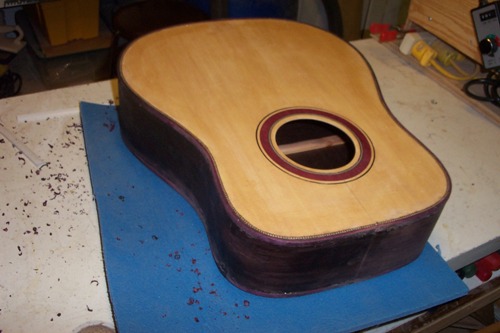

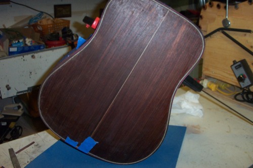

I have used the brass edge guide that attaches to my stew mac base for 13 guitars. However I do not recommend it. It is a long job. For me the low power of the Dremel is not the problem because I make light passes. The arch of the back is the problem. It can be done with this tool but you'll have to touch it up with more depth adjustment in lots of places. Here's a pic of a guitar I put bindings on the other day. It has top purfling and side purling.
I cut the binding first on mine.
