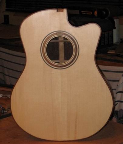

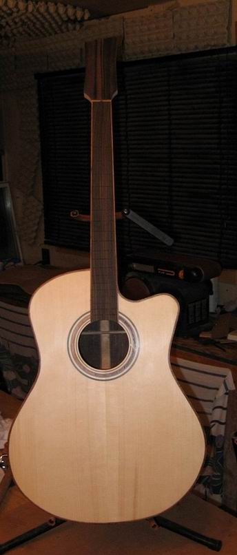

So now that I've managed to figure out how to downsize some pics, here's my second in progress.
Specs:

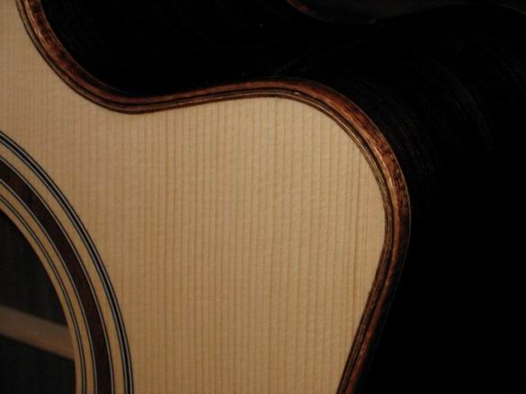

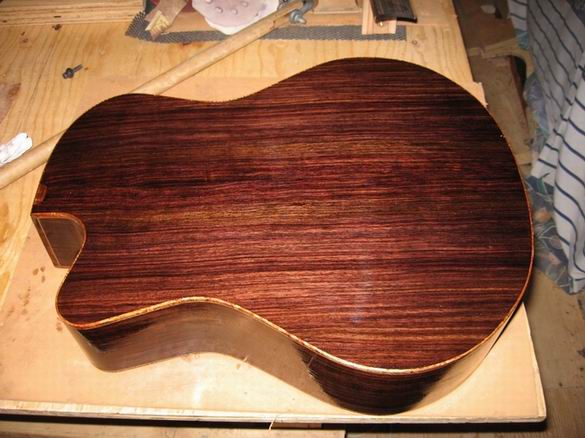

Adi top, Master Grade EIR back and sides, Flamed Koa trim and rosette, Mac Eb. FB and head plate.
That is a shape I drew myself. I call it a Modified D***d. I just took my old Takamines shape, tucked in the waist, flared the bouts and dropped the shoulders a bit.

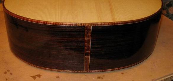

What you see on there is a coat of System Three Epoxy on the back and sides and there's a wash coat of Super Blonde shellac on the top.
I got my binding and purfling from Shane at Highmountain. Awesome stuff and as always, top drawer service from one of our sponsors. Thanks Shane!

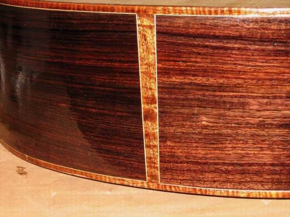

So from the inside it's koa/maple/koa/EIR/Koa

I really like your binding and rosette. Overall beautiful design and workmanship.

The more I see this combo (dark b/s, Koa binding), the more I like it. It is really handsome. One of those things to do for sure.
The single white purfling line on the sides was a gutsy move--but you pulled it off quite well.

Very nice shape Alain,and beautiful Rosewood.I also like the koa binding and rosewood combo. Very good work!

Steve, the single white purfling was more stupidity than good sense Let's just say I'm not about to attempt than one any time soon...

Pete,thanks man. The purfling I got from Shane was koa/maple/koa. Gorgeous looking stuff. I felt bad having to hide those flamy sides in a channel! I added a very thin 0.020 EIR lam to the Koa binding.. The EIR lam. had the same height as the binding. It was a bit of a pain in the derriere but worth it in the end.

I really love that EIR/koa combo, especially with the white side purfling detail. Very nice touch.

I love the modified shape, great looking work!

I love the rosette, binding and purfling, and end graft.

Looks good, Alain, and kudos for taking the originality route!

awesome! I always enjoy when I see newbies put smaller/classier end grafts
in... looks like a cool guitar, and great job on the binding/purfling.

I still haven't attempted the mitered lines on the binding yet. You are doing
it on #2. Simply fantastic.

Way to go, Alain! I really like the shape you came up with. Got yourself a winner there!
PostPosted: Sun Jul 09, 2006 9:27 am
Posts: 1018
Location: Denver, Colorado
Alain, that's sweet! I really like the "dropped shoulders" and the binding/
purfling scheme. Nice job!!!

I'm really glad you like the shape. It really jumped out at me once I drew it, but then again, I'm a bit partial/biased.    I couldn't wait to get it done and see what it really looked like in person.
Now I can't wait to start another one!
