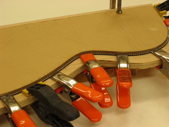

Soak it for 5 minutes in warm water, then take one side of your bending form and attach it temporarily to a piece of plywood...bend the herringbone around the form using spring clamps to hold it flat and in contact with the form...leave overnight...works great...below is a link to the OLF thread where I originally asked this question, and a photo of the way I went....

Good technique. if you have bender you can bend it in the machine also. I tape it to binding when I bend so it won't twist. I like simple and the above pic works. Before the bending machine days I used to heat it in HOT water then tape it to the guitar over night.

Thanks Larry!
I'm going to use this technique for my next herringbone. The firs stuf I bent was tough to keep from twisting - this method looks like it will solve that problem.

Sure thing Mark! I bought 2 extra strips when I did it and didn't even have to use it! Looking forward to seeing your guitar pix posted on the OLF!
