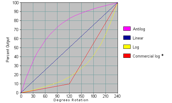

Figure 4 - Potentiometer Tapers
First, the term "taper" needs some explanation. In the early days, when an audio taper (logarithmic, or just log) was needed, the resistance element was indeed tapered, so that it provided a different resistivity at different settings. By changing the physical taper, it was possible to make a pot provide the exact gradient of resistance needed. By definition, a linear pot has no taper as such (the resistance element is parallel sided), but the term has stuck, so we might as well get used to it.
The violet curve in Figure 4 shows an antilog or reverse audio taper pot. These are quite uncommon, but used to be used for balance controls using a log/antilog dual section (commonly called dual gang) pot. It is shown on the graph mainly for its interest value, but they are generally an historical component now.
All this tapering proved a rather expensive exercise, so manufacturers economised ("they" won't notice the difference!), and worked out a method of using two resistance elements of differing resistivity, and joining them to create what I referred to as the "Commercial log" taper. In short, it doesn't work (not properly, anyway), and the discontinuity where the two sections join is almost always audible with cheap "log" pots.
