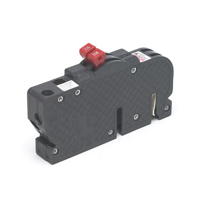

Bob if you have room for another circuit breaker in the box the safest thing would to be run another new circuit. If you dont you can buy a twin pole space saver breaker at home depot. This splits one loacation in the breaker box to two. This allowed and safe in most areas.
