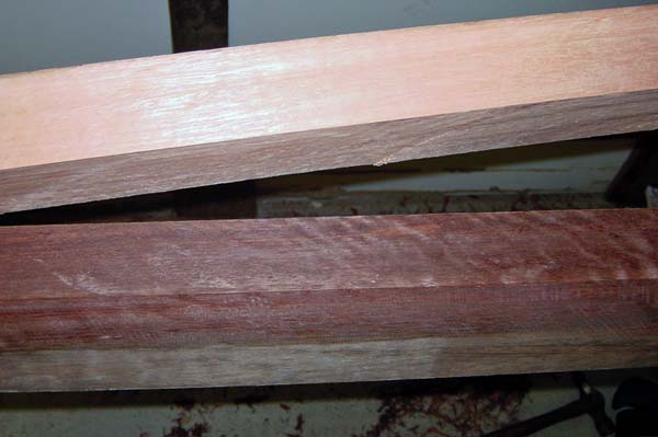

The first image shows 2 pieces of Jarrah, there is no sap wood here, it's just how this stuff comes. The image has not been touched-up, if anything, the darker stuff with the curl looks much lighter in colour due to the flash.
The salmon pink stuff is lighter by weight as well as colour. This weight colour relationship is so predictable that years back, when I was making staircases for a living, if a client ordered a Jarrah staircase, I could pretty much colour match the hole job when selecting rough sawn boards from the supplier just by using variations in weight as an indicator.
We used to fool around sometimes and would install darker treads and risers down the bottom and take it toward the pink hues at the top, or dark treads and handrail with light spindles used for the balusters. Sometimes you get good curl, sometimes a black fleck similar to that found in tiger myrtle but less intense quite often both in the same board.

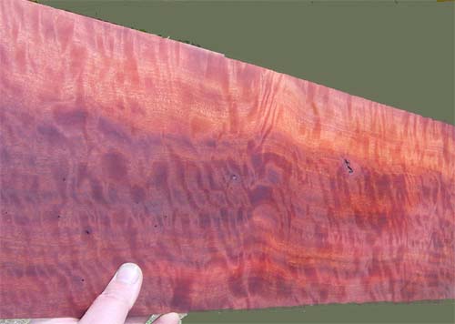

Here is a curly board with a bit of fleck and a rough gloss finish.
Here is another with a broad kind of quilt.

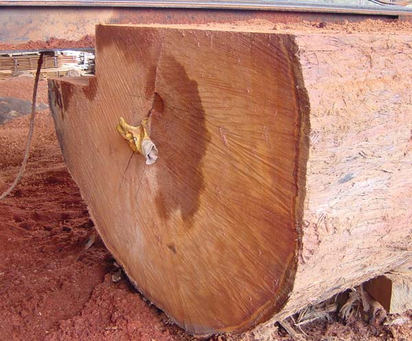

This is one of 4 clean logs cut from the same trunk.

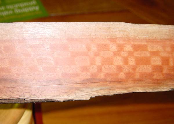

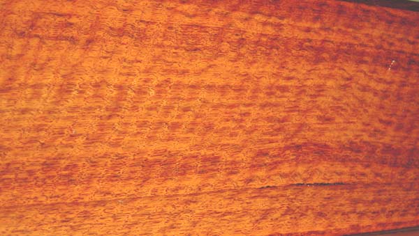

Fascinating wood: It amazes me that geometric design can exist in nature!!
I suppose you can make a natural version of this;
Being serious tho, my gut instinct tells me that that wood is pretty lethal on the ole lungs...Sam Price38914.1354166667

[QUOTE=Sam Price] Fascinating wood: It amazes me that geometric design can exist in nature!!
I believe this figure type is referred to as "block mottle". Common in makore as well.

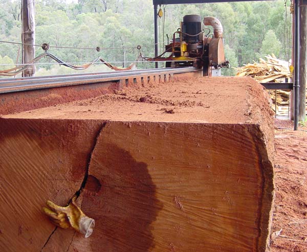

What can you tell me about the saw setup in the background?...the beam is clear to see but I can not see the saw mechanism as to whether it is a circular saw type, a bandsaw or a chainsaw blade.

As for the saw, tis a loooong bar chain mill. Just for interest, because of the shake in the centre, the entire log from which the one of four pictured came from (and believe me, the log looks about 1/4 as long as it really is in the image) had been rejected by our forestry management people and was destine for the firewood market.
Thankfully, the miller had out bid the wood carters and resawed the lot for the furniture trade. Up until just a few years back, most of the figured stuff was burnt, the curl was not desirable in structural grade timber and the furniture trade seen it as a fault .

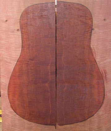

If any forum member wants to experiment with a Jarrah set I am prepared to offer sets at a discounted rate ($70 USD plus $25 Shipping). These would be reasonably straight grained sets with good contrasting reddy brown bands of colour. For your reference/database I have included some images below of Jarrah sets at the upper end of the grading range. They have excellent fiddleback and colour.

So exactly where have you been hiding that awsome set Mr Spittle    Looks great Tim, what price do you have on that stunner??
PostPosted: Wed Jul 19, 2006 2:51 am
Posts: 228
That is a very good question Kim!
The dreadnought set is one of five and will be available in September. They are priced at $120 USD per set and forward orders are welcome.
